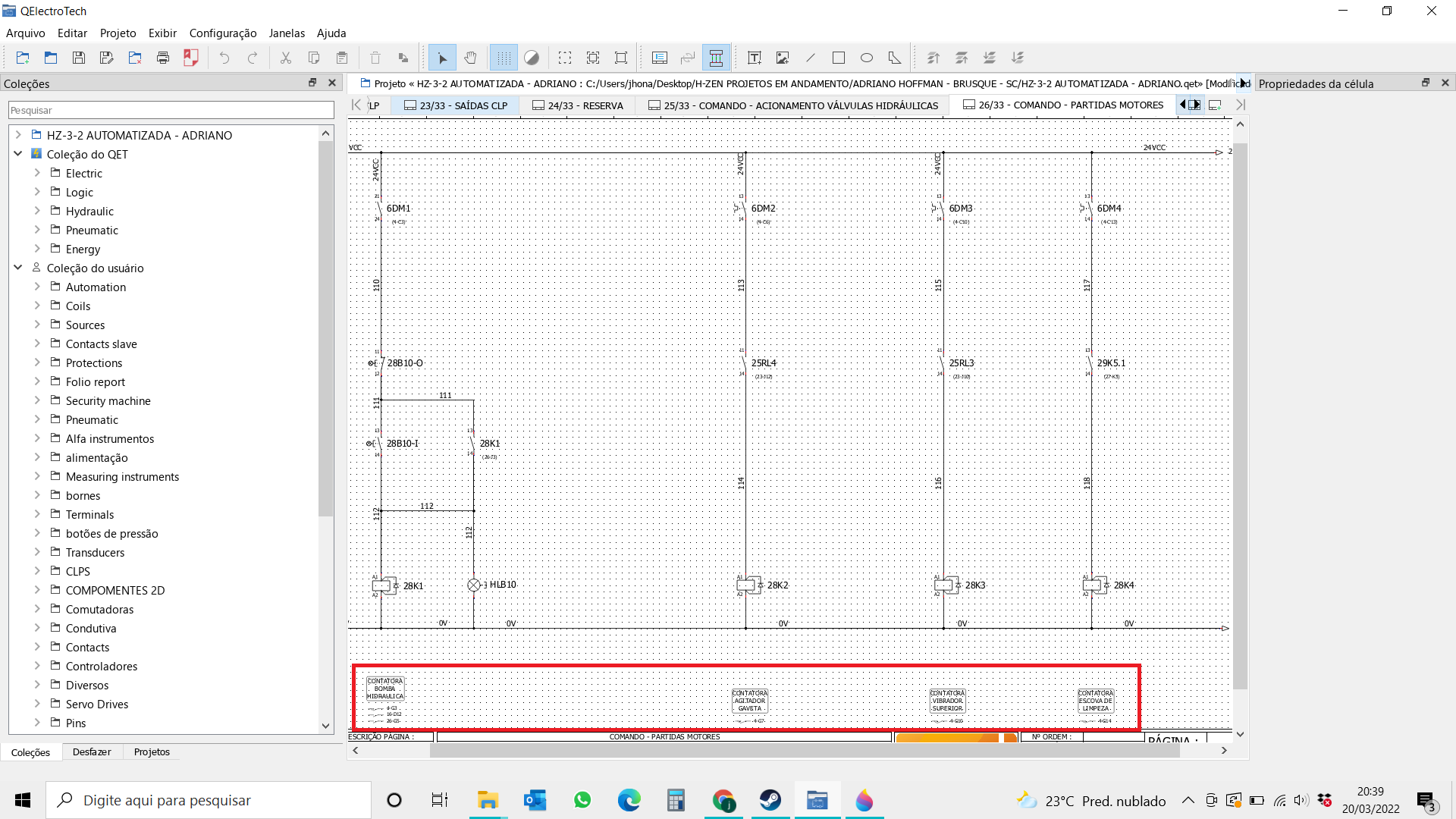

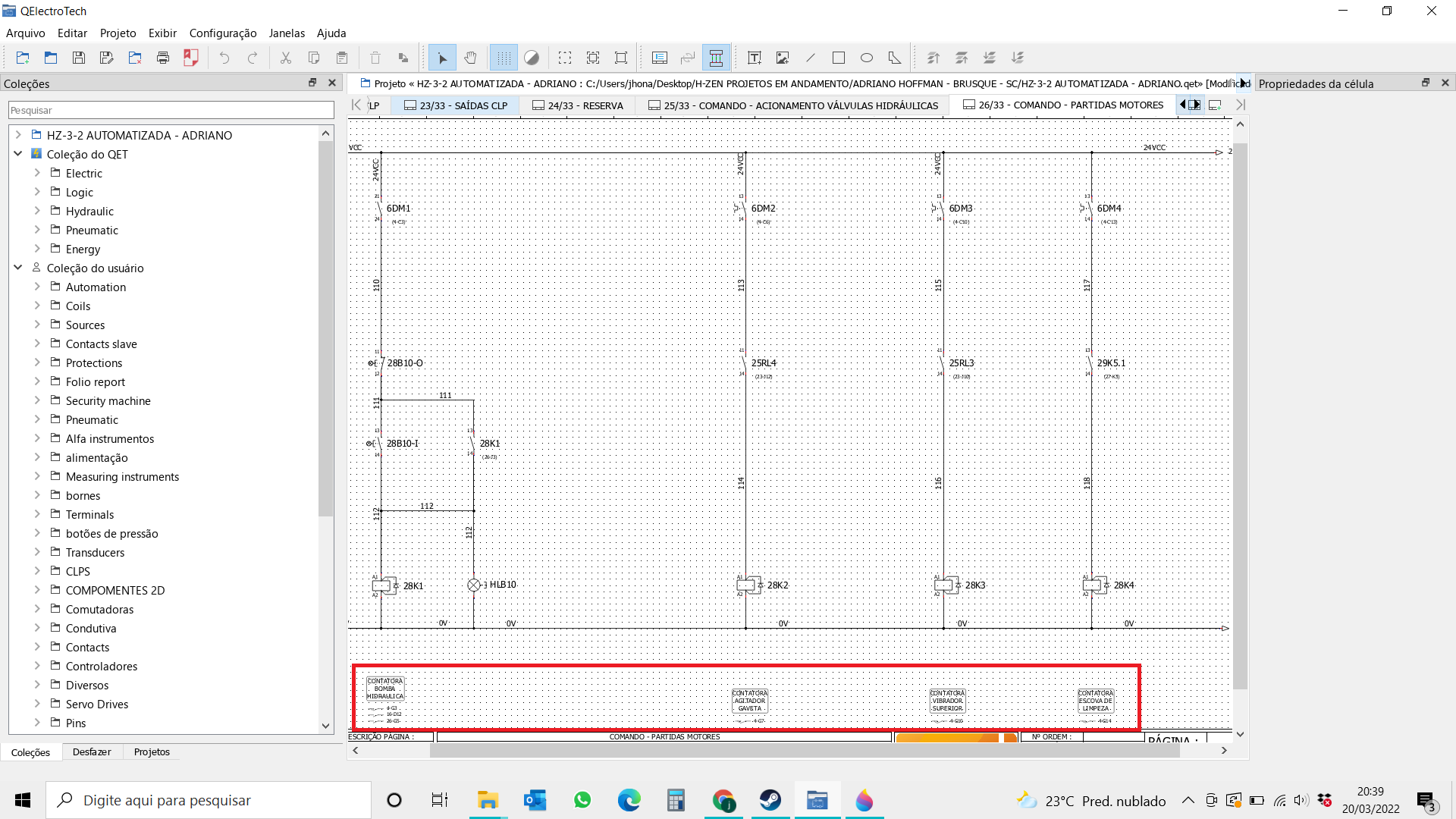

I have been using Qelectrotech for a long time, since version 0.3, and I always follow its evolution, and I am very grateful that people are working and seeking to improve Qelectrotech.
I upgraded to version 0.8, and noticed that the comment at the bottom of the element was not generating automatically.
I believe that the function of the comment below the element (coil of contactors, relays among others) is very useful as information in the composition of the electrical schematic.
considering that when analyzing the electrical schematic, and having the comment with information, an ease is created, as it already directs to its activation.
I know that it is possible to edit the element and place the comment below the caption, but this is a lot of work, as there are dozens of items to be changed.
the question is:
It is possible to recreate the arrangement of the comment automatically below the element, or a configuration that enables this ''function''.
Here are some images for examples.
Goodnight.

You can do the same thing but in another way since QElectrotech 0.7.
In the properties panel of element, you need to add 'comment' text (if not already present in the folio), you can save/load the text configuration of an element to avoid to do the same thing for hundred of element.
I let you see and play with these new features.
https://qelectrotech.org/forum/viewtopic.php?id=1441
https://download.qelectrotech.org/qet/m … _text.html
https://download.qelectrotech.org/qet/m … texts.html
