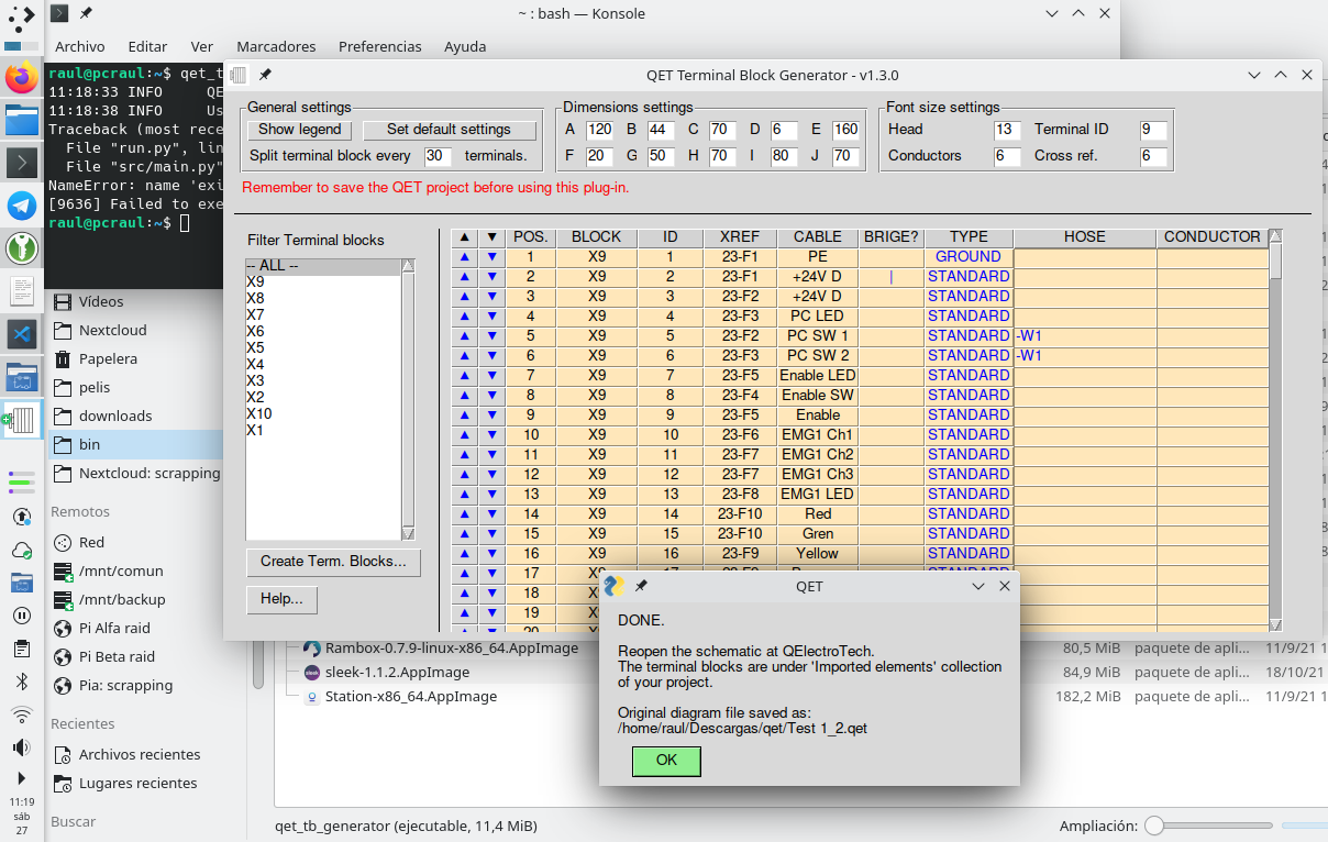

19 (edited by unalcalde 2021-11-27 12:35:29)
Re: It takes too long time to open a file *.qet
The problem is: "xml.etree.ElementTree.ParseError: not well-formed (invalid token): line 5, column 13"
There are a '<' simbol alone. I remove it and QET can open the diagram.
Later I'll check why append.
Screenshot1.png, 245.39 kb, 1208 x 766

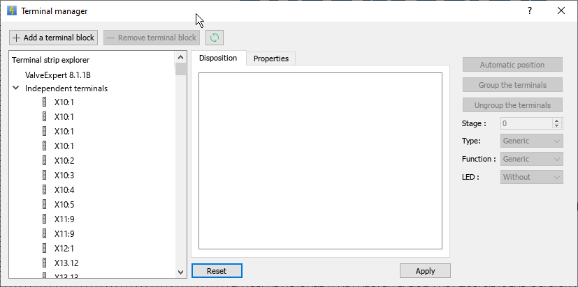

Hello Unalcalde,
I've also played with "Terminal manager".
A structure was made, but it disappeared after corrections suggested by Laurent.
Now all terminals belong to "Independent terminals" block.
Could the "Terminal manager" responsible for the problem?
Thank you,
Mike
