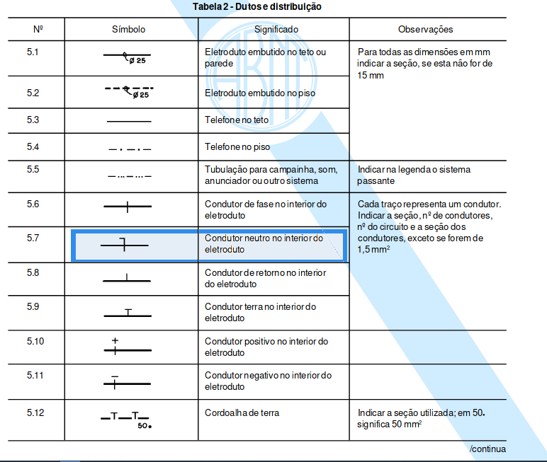

Hello people ! I am dealing with the following problem. In Brazil there is a standard (NBR 5444), Graphic Symbols for building installations (As you can see in the attached image), this standard uses some different symbols and here in Brazil is what we use. In Qelectrotech there is a symbology based only on IEC. Could you include more symbology options ???

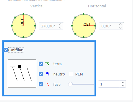

Symbology used in Brazil, based on NBR 5444. Similar to IEC, but with some differences !!

Hi, are you sure? for me is only electrical conduits indications, like en_60617.
http://ftp.demec.ufpr.br/disciplinas/TM … ediais.pdf
Re: Types Icons Unifilar
Yes I'm sure ! In Brazil, all symbology to represent conductors in conduits is used to NBR 5444. More options of graphic symbols could be added.
