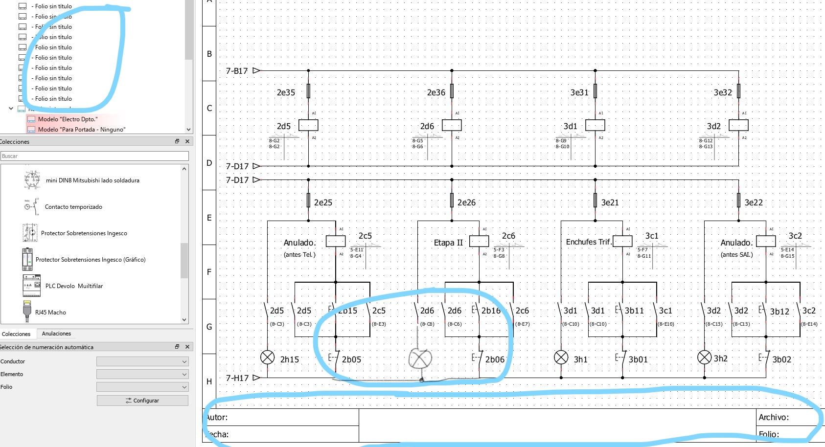

Only the second possible bug:
marin.molina wrote:
2) Then I tried to open this files with other PC [(Win10Pro) (QElectroTech V 0.8-rc+4c356cd...)]
and  I lost info (like titles of the folios, some connections...)
I modified a file with QElectroTech V 0.9-dev-78-g4051bbd30.snap in  Ubuntu 20.04, and now I open with QElectroTech V 0.8-rc+4c356cd... in Win10Pro, and a new popup windows advice me that the version of this file appears to be different and if I click ok and open it I lost the tittle of the folios and some conductors and elements... (see attached screenshoot)
Try last builds.
I will try in a few days in my Ubuntu + QET v0.9, now I dont have acces to this PC
Captura - QET - Ejemplo de info perdida_LI.jpg, 1.16 mb, 1686 x 914
Re: Problem opening .qet files creates with v0.9 and v0.8
Open project with new QET version isn't a problem, but open your project with version -1 is not a good idea, is very risky and you can loose some things.
