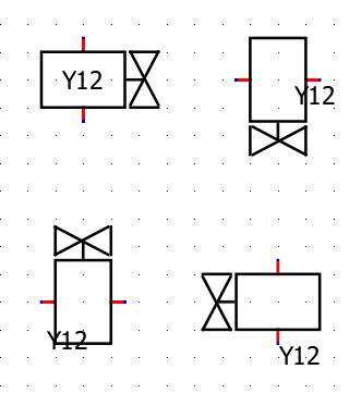

Good day, I have updated qelectrotech v0.8 recently and noticed text orientation changes weirdly then rotating elements. Is this new behavior, or this is a bug? Any way to fix it?
In older releases text rotated with element and stayed in same rectangle, boundary.
Edit: I have found property in symbol texts for specific text "Maintain visual rotation", but it applies only for already placed element, so far haven't found similar option in element configuration.

Hello, I also considered this an error, but today I see it as an advantage, you can select the text and press the space key, that the text rotates and keeps the correct position.
Before, the text rotated in an unordered way, if you do not select in the editor to rotate it with the element. For me it is best to choose the rotation of the text.

Thank you, it is a somewhat workaround to place element then drag select all its parts and rotate, still would be nice to have same option in element creation, to change default behavior per element.

This is no longer working in 0.9 QET, and selecting text with dynamic text removes dynamic text bindings, back to default "_".
