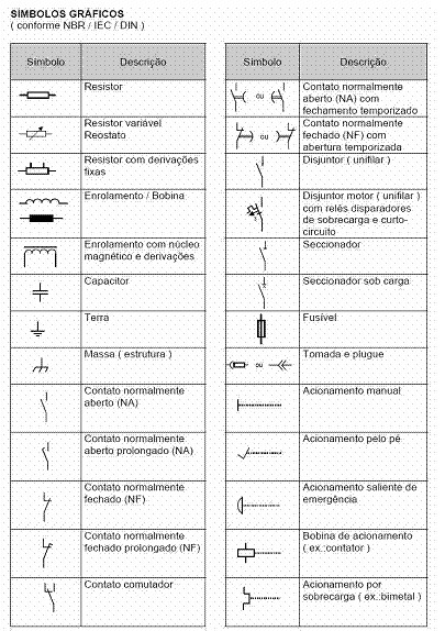

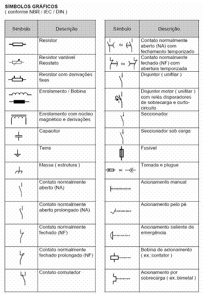

Many industrial electrical projects have a type of "summary of elements" that are used throughout the development of the project.
I know that in version 8, they already have two ways to add, summary of pages and the nomenclature of the elements.
My suggestion would be if you could insert the design of the element and its name. It would be like a page with the design of the element (perhaps on a smaller scale) and its name. Below I put an image of an example. It remains as a suggestion.
foto.GIF, 21.23 kb, 405 x 574
