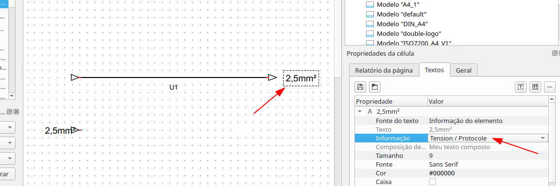

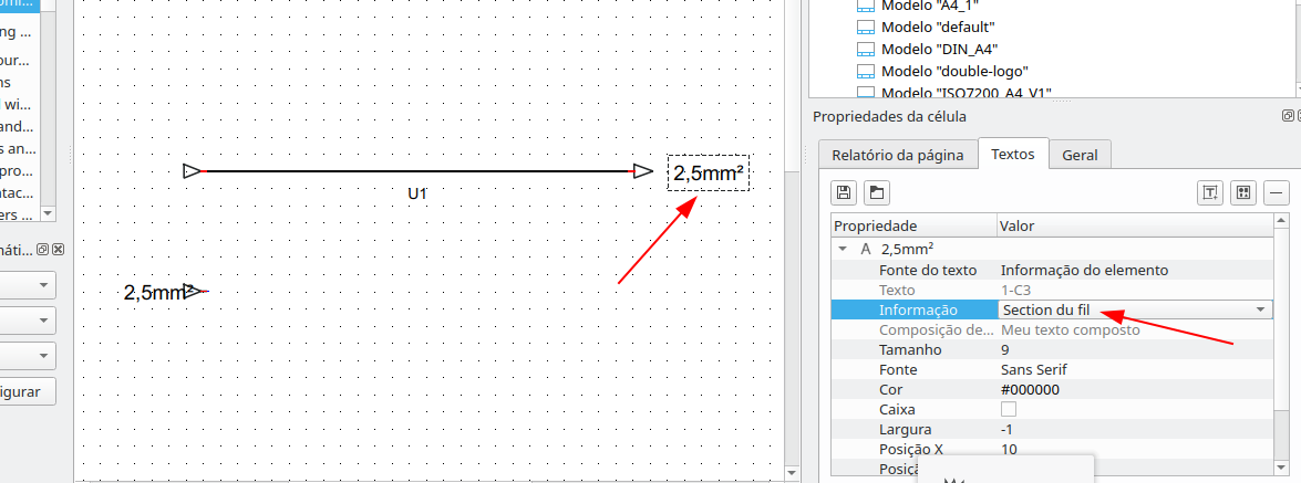

Hello people !
I am using Qelectrotech V8 DEV version.
I have a problem, because I can't put the Voltage information in the page reference element.
Other information is shown correctly for example: Function, Color, Section and etc ...
2020-12-02_14-29.png, 59.14 kb, 1175 x 437

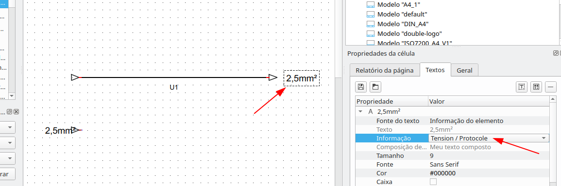

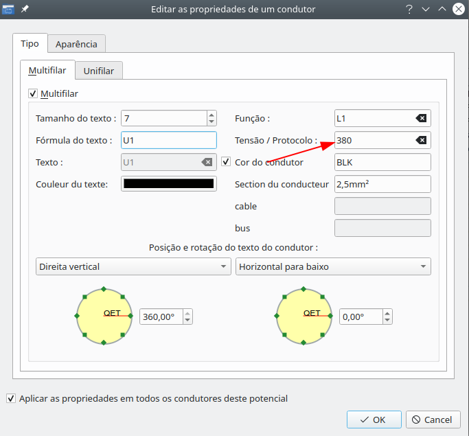

gleissoncg2 wrote:
Hello people !
2020-12-02_14-29_1.png, 51.36 kb, 1155 x 384

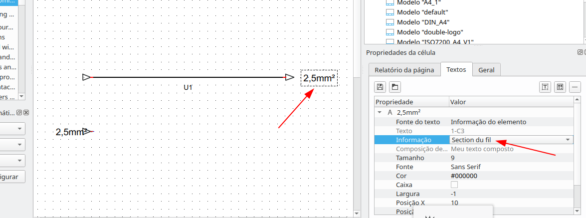

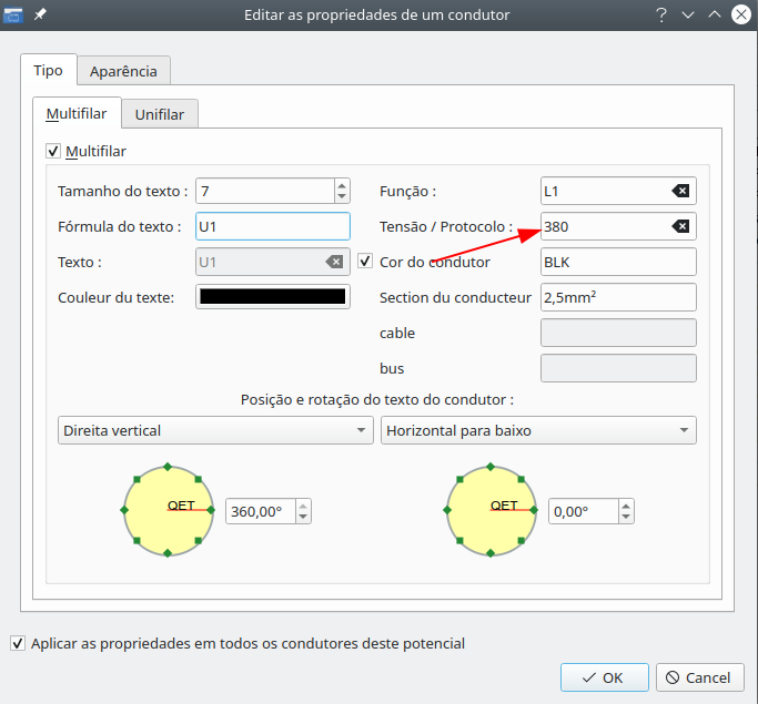

Re: Problem with information about Tension/protocol
gleissoncg2 wrote:
gleissoncg2 wrote:
Hello people !
See bellow the information on wire...
2020-12-02_14-28.png, 51.6 kb, 683 x 635

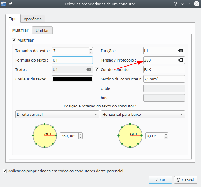

https://qelectrotech.org/forum/viewtopi … 696#p13696
Great! I'll try! Thank you!
- Log -----------------------------------------------------------------
commit b22741732b02863ce70c13eb7270df588d10cd70
Author: Claveau Joshua <Joshua@>
Date:   Fri Dec 4 21:07:42 2020 +0100
    Minor fix : folio-report information 'tension_protocol' isn't displayed
    When a folio report have a text item witch must display the information
    'tension protocol' the text is empty.
    Replace the string 'tension/protocol' by 'tension_protocol' in
    QETInformation namespace.
    Move the static QStrings of the namespace QETInformation from
    qetinformation.cpp to qetinformation.h to be use everywhere in the code.
