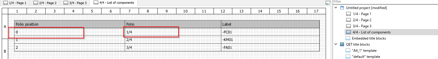

I found one strange thing and I would like to ask whether there is a possibility to set the starting number of folio position in Nomenclature.
When I generate the nomenclature, folio position starts by 0 (but it is page no.1) but folio number is i.e. 1/4 (see attached screenshot).
Thank you for your support in this case.

Hello,
I today tested new release of 0.8 dev and this point is now solved.
Thanks a lot!
