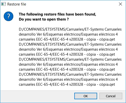

How can I avoid the restore screen as the attached one?
your previous projects crashed, the program will try to reopen them.
if you click the OK button, it tries to reopen your projects or click to cancel to not restore those files. Hope you have a backup of these files elsewhere.
Or manual delete files on C:\Users\jponsa\AppData\Local\stalefiles\QElectroTech\
