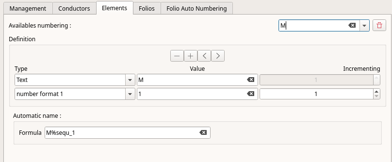

Is it possible to make individual autonumbering for different components type. For example separate components quantity counter for relay coils, motors, buttons, etc. With a formula
%prefix%sequ_1
I'v got continuous numbering - K1,K2,K3,M4,M5,M6,SB7,SB8...
But should be K1,K2,K3, M1,M2,M3,SB1,SB2

Hello,
for each element group you create your own automatic numbering rule (relays K, switch S, fuse F)
Depending on what you want to insert for an element, you use the numbering rule.
Sincerely yours
Stebo
