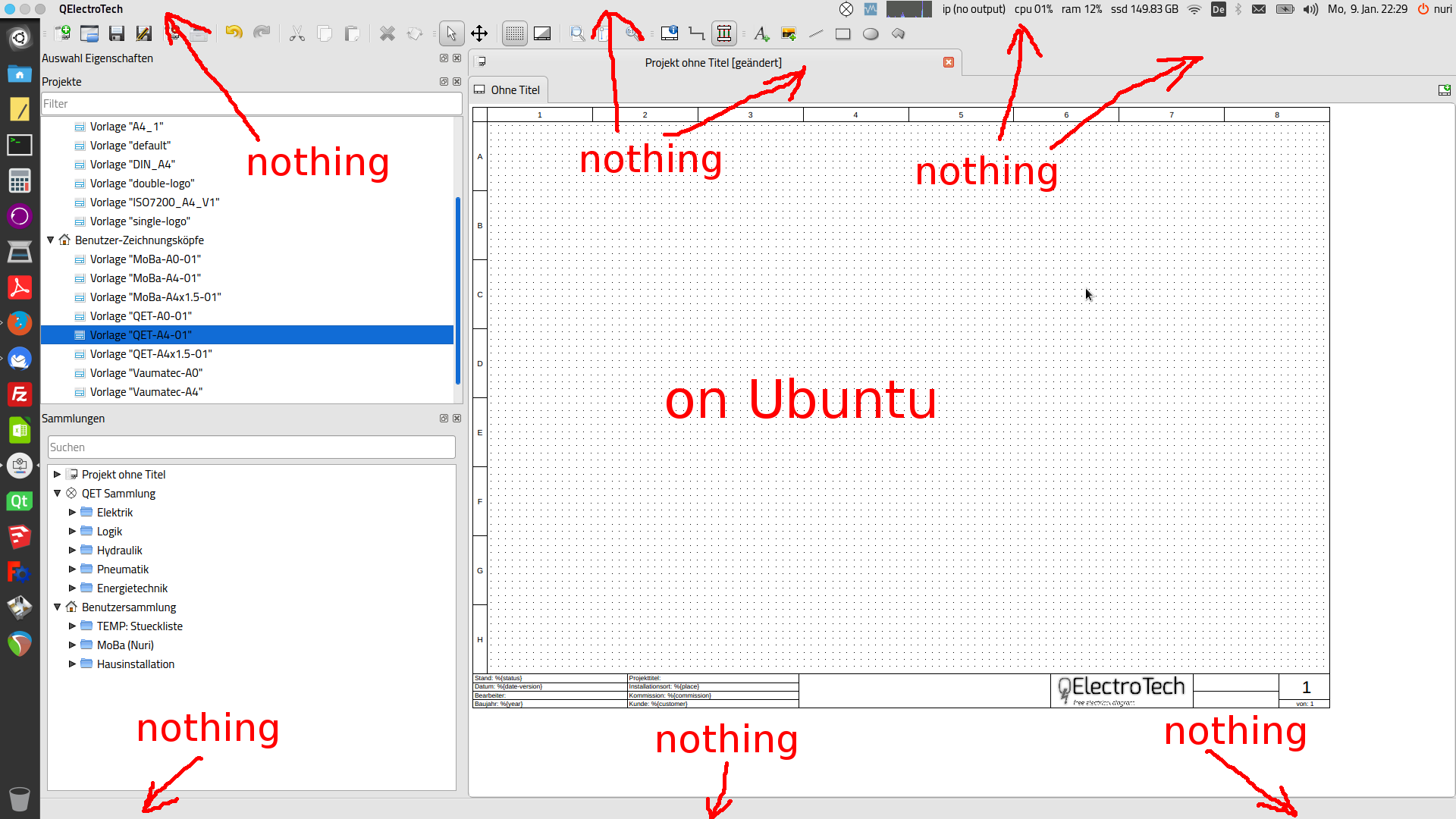

I also miss a field where I can see what for project I'm currently editing.
I think the top window bar is a good place to show the edited file name. At the moment it's only showing "QElectroTech".
It would be nice if something like that could be implemented:
"QElectroTech - Project: myblablablaproject.qet"
Of course, the "myblablablaproject.qet" input should be updated when the user switch between several opened projects.

10 (edited by Nuri 2017-01-09 23:34:08)
Re: BUG?: Save remains disabled after certain project changes
nomicons/smiley-green nomicons/gne nomicons/smiley-green
nomicons/whistling
https://download.qelectrotech.org/qet/forum_img/nuri_path.png
Making the project path and filename visible in the SW was a good idea and generally speaking, very handy.
It was absolutely necessary to aid the work around of doing a "Save As".
