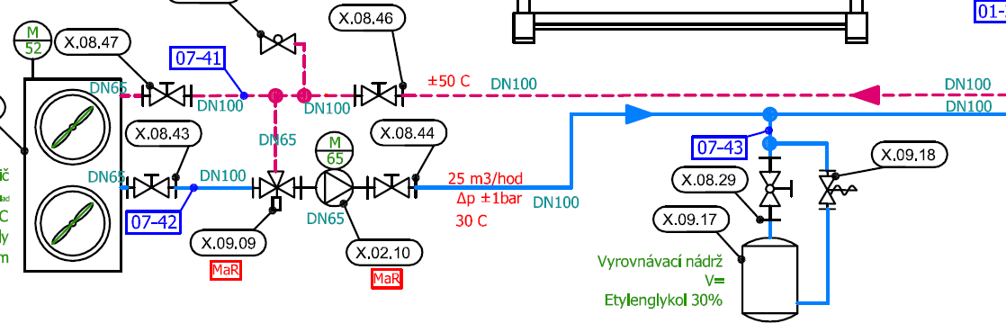

Hi all,
is it possible to have the labels of the elements connected to the elements and visible on the scheme. Something like in the attached picture. If not, I suggest it as an possible future :-)

Hi Radar,
I think you could see these links:
http://qelectrotech.org/forum/viewtopic … 2274#p2274
http://qelectrotech.org/forum/viewtopic … 3141#p3141
Yes no big problem, you can make it yourself.
use the edit element function to make the roundedlabel, when time i will make them in weekend.
then make also the dot as separate element.
on both make 4 connections.
on the diagram insert both and fill in the text field.
then put a wire in between them.
if you make a link (previous next you can make a list of all on another page.
another way is to define them as a terminal.
I made the rounded label, and I was trying to import it by using Element DXF Converter. But it imported only the text ...
Why do not use Qet editor for drawing your rounded label?
Dxf converter don't convert binary files.
so I made the buble
that was the dot, now the buble.
But How do I connect the text inside the buble vith the name of the actual element?
Perhaps you could play by change property of valve element and rounded label?
Look report folio propery:
example:
Valve to property "report folio in"
Rounded label to property "report folio out"
Or master/slave property
