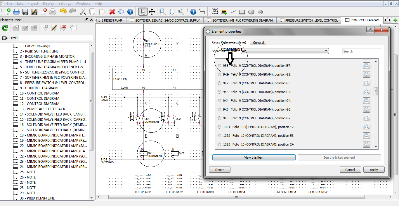

Hi All,
I have tested QElectroTech with little bit more diagram and meet many difficulties,
may i request to add comment as creenshot attached?

Hi scorpio810,
Thank you for answere,
I set 9S1 as master, sometime i need to add auxiliary contact to 9S1. i need comment to it, but when i enable comment 9K1 comment overlaping by 9S1 comment.
It is easy when 9K1 (master & slave) located at the same page, but it is difficult to remember and recheck when 9K1, 9K2, 9K3 (master & slave) located at differrent page.
When we work with more than 80 relay and contactor (master & slave). add comment at slave contact will helpfull to us when we want to recheck diagram.
Dialog box [Element Properties -> Cress reference]: add comment affter label will help us to ensure that we have chose the right slave without jump to master element located (just to read master element comment).
Thank you,
Ok, i see the problem, now all element can show comment in bottom of page and overlapping all items.
I think show comment under element label is better. We'll think about it.

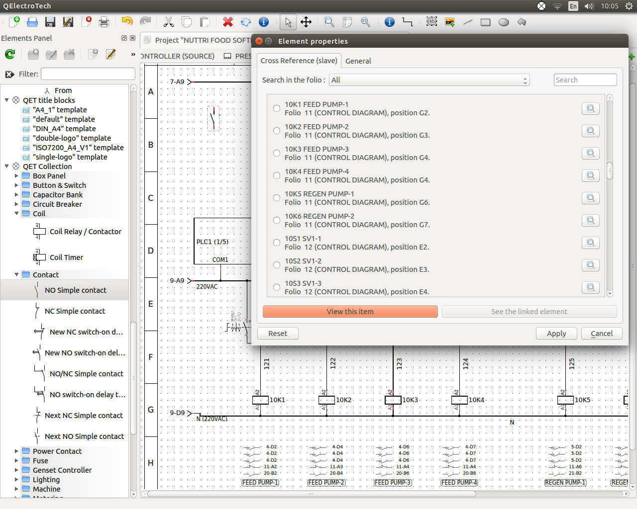

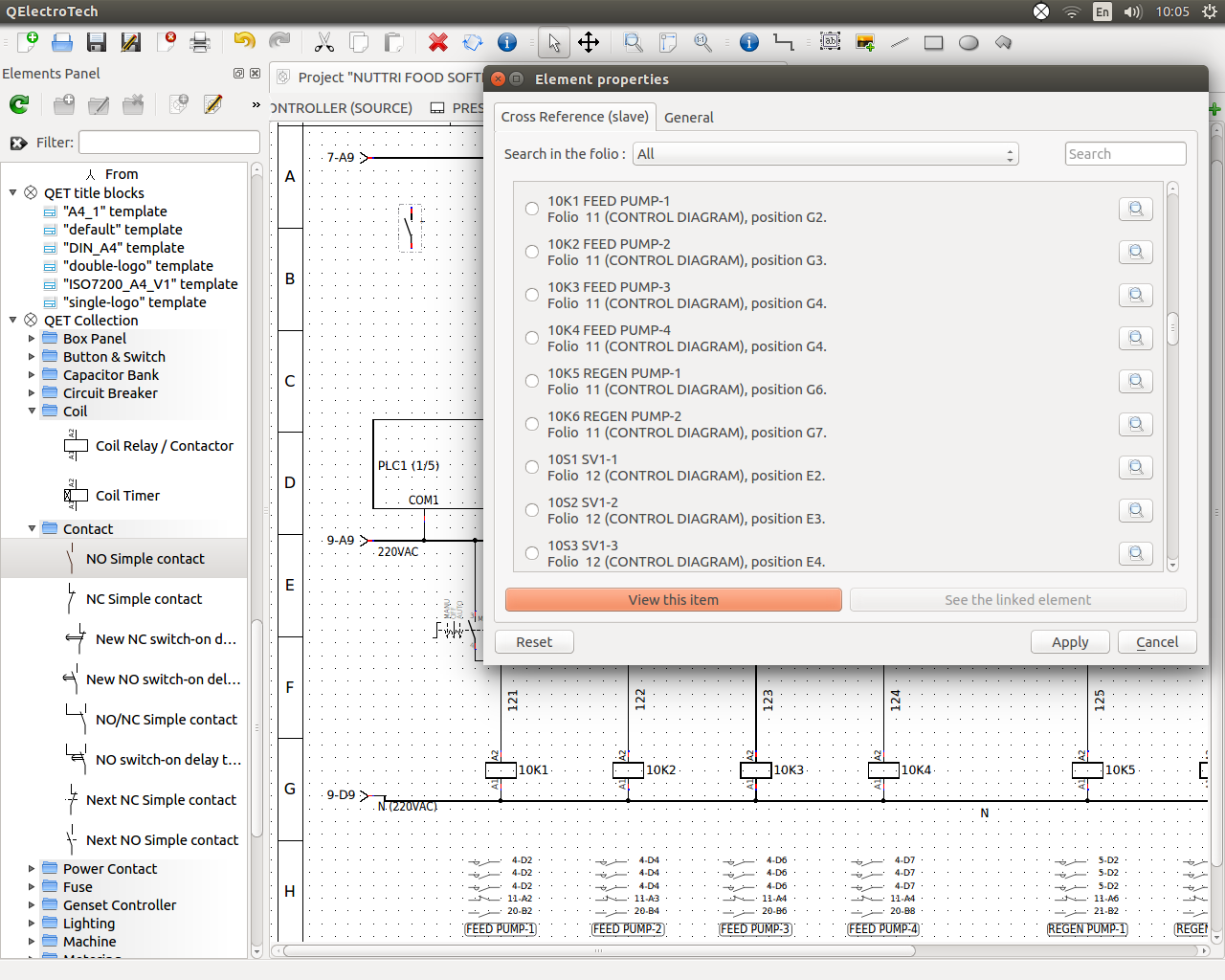

Dialog box: Element Properties on Ubuntu 14.04 Element Comment displayed properly but not displayed in Windows 7.
Thank you.
Comments run well in dialogbox Element Properties on Windows seven.
