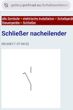

Does this element already exist somewhere?
It's a switch that allows the user to choose between grid-tied operation and off-grid operation, with a lagging zero (or delayed zero-crossing or Slaved neutral). Not sure the right naming.
I'm not sure how to represent this in a schematic, hence my question — I'd like to get it right.
Thank you.

Re: Sontheimer Switch-disconnector LO63 ULO63/4T/NS/Z101/F976
As a hint: https://download.qelectrotech.org/qet/e … index.html
EN 60617 - 07-04-02
and see attachment
