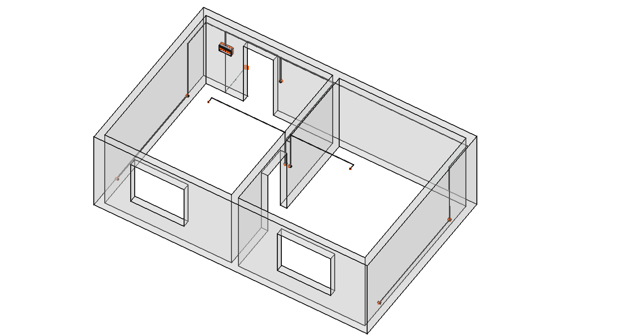

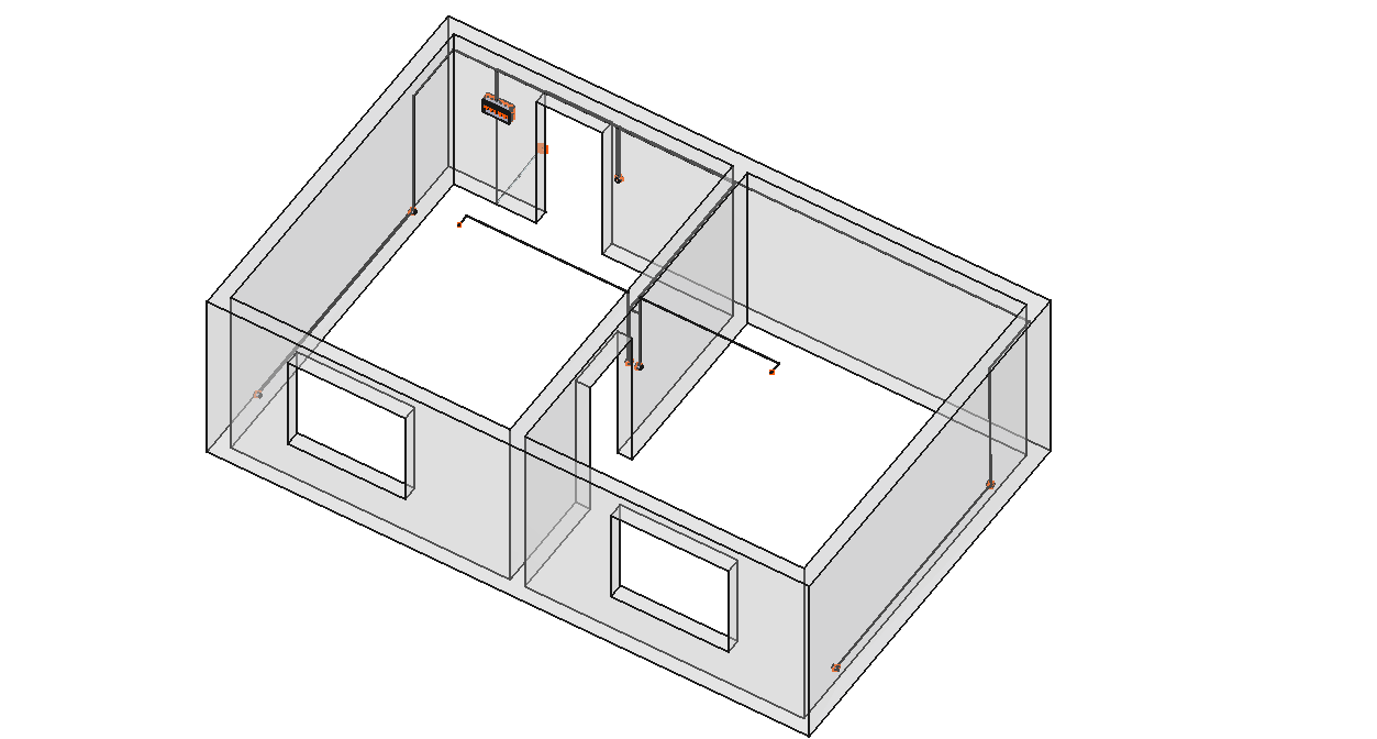

3. Run an import script which will be able to create complete model of all elements, cables and connections in FreeCAD based on diagram from QElectroTech. Location of elements should be as close as possible to their final positions in the 3D space. At this stage, wires are just straight lines connecting elements.

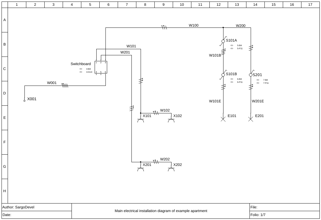

I had to use some tricks in QElectroTech diagram to achieve my goal (see apartment_example.qet below). Do you think it is practical to make such a diagram?
Does it break any established rules?

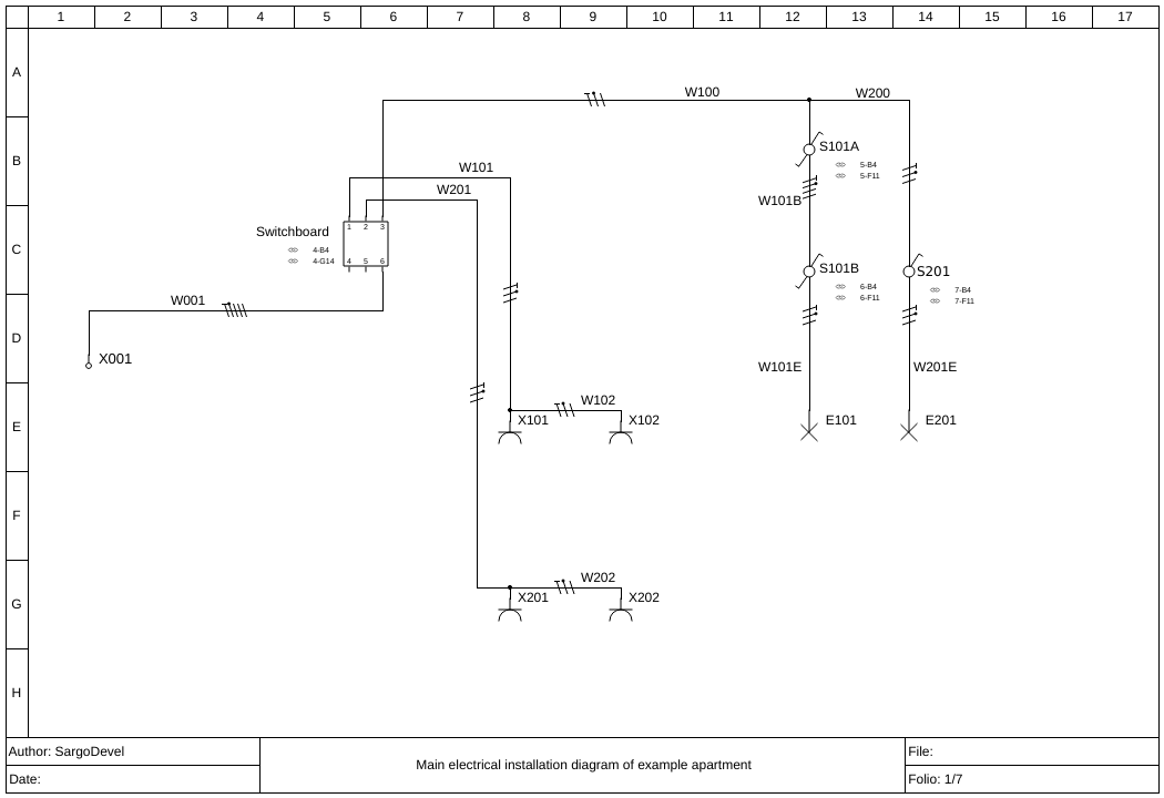

2. Make diagram of home electrical installation in QElectroTech as detailed as possible
The QElectroTech example project file: apartment_example.qet
Folio 1 image from above document: apartment folio 1

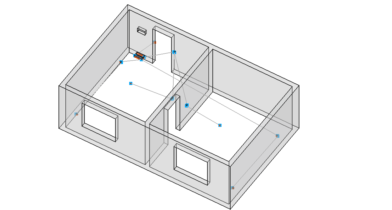

3. Run an import script which imports folios 1,2,3 from apartment_example.qet. At this stage, wires are just straight lines connecting elements.
The image from FreeCAD example apartment file after importing folios 1,2,3: base_wires.png

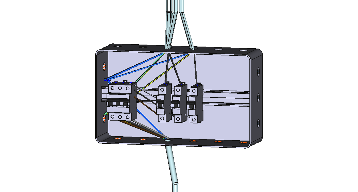

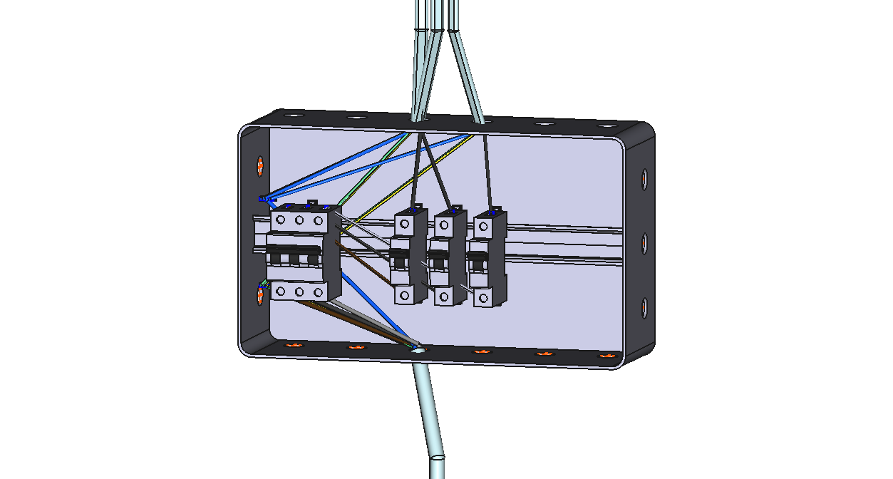

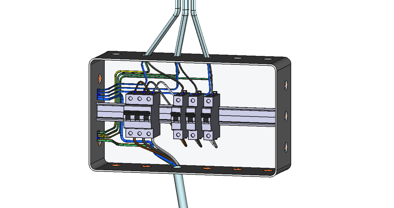

6. Run import script again to create all missing details: full cable shapes with all single wires and all interiors of distribution boxes with all connections inside
The image from FreeCAD example apartment file after steps 4,5,6 and after importing folios 4,5,6,7:
The switchboard after automatic import: switchboard.png

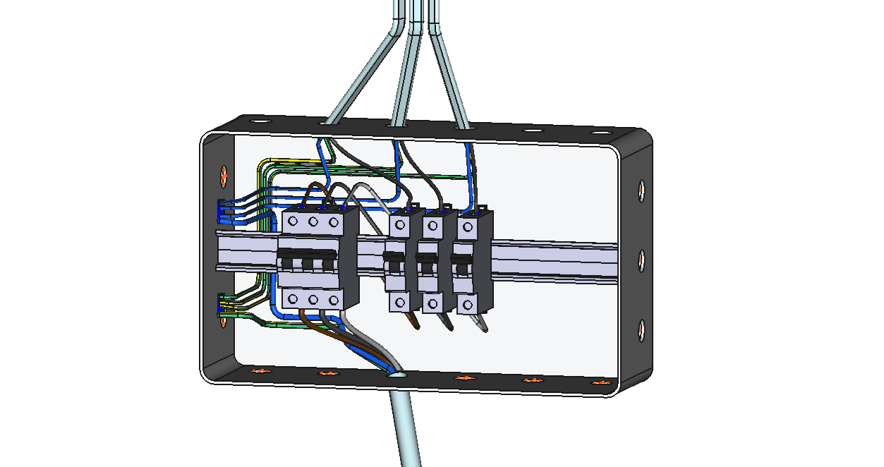

7. Final manual adjustment of cable routes and element placements
The switchboard after manual routing: switchboard_final.png

1_main_electrical_installation_diagram_of_example_apartment.png, 37.46 kb, 1050 x 720
1_main_electrical_installation_diagram_of_example_apartment.png 37.46 kb, 37 downloads since 2026-01-12
