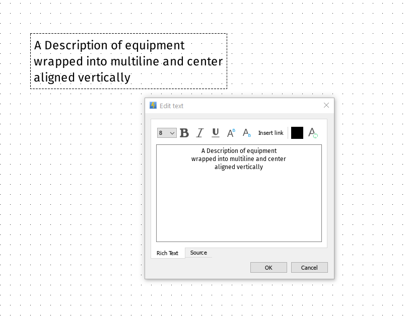

It is possible to have text center aligned vertically. I have used some simple HTML to center align the text. In the editor the text is center aligned, but the final text is still left aligned. Currently I create multiline texts and pad them with spaces to center align vertically
Below is autogenerated HTML for attached image

The attachment did not load
Screenshot 2025-05-07 135142.png, 29.34 kb, 808 x 634
Re: Vertically center aligned indepedant text
Should be supported according to this resource from the underlying QT implementation:
https://doc.qt.io/qt-6/richtext-html-subset.html
Have you tried settings the width to 100% on the paragraphs?  You have three distinct paragraphs, which should align wrapped lines centered.  But if each paragraph only contains one line, it will not wrap.  And each paragraph is probably left-aligned within its parent, not even taking the full width into account.
