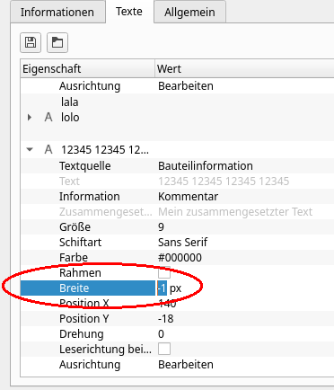

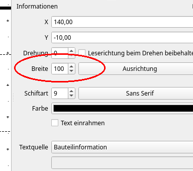

Maybe this helps:
In Element-Editor you can set the property "Width" for dynamic_text.
Then the text is automatically wrapped at spaces.
You can also set the Property "Width" afterwards in design-editor.
Bildschirmfoto_mehrzeiliger_Text.png, 14.68 kb, 384 x 340

Bildschirmfoto_mehrzeiliger_Text_2.png, 25.87 kb, 372 x 434

Re: Text fields. Special characters
Thanks, it works quite well ))
