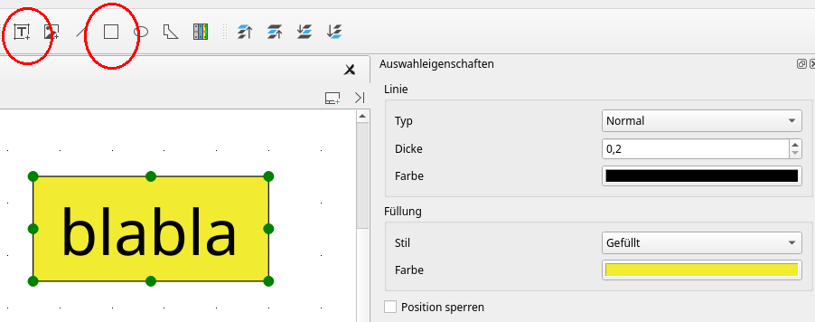

You want to place free text in the diagram and want to set a background-color for the text?
Placing Text is possible ... see screenshot.
For the background-color you need to do a workaround with a colored rectangle placed behind the text. (see screenshot)

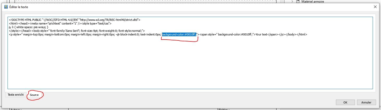

You can do it in 1 step with html directly on text. Add on html source : background-color:#0010ff (change color hexadecimal code).
