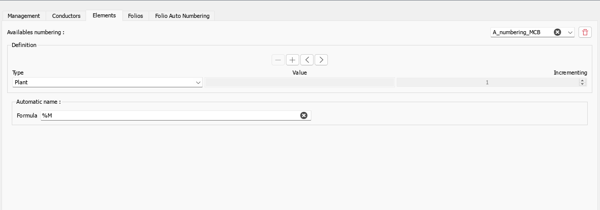

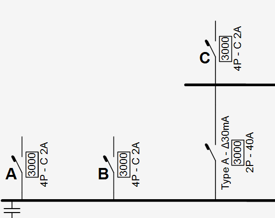

Hi.
after a bit of struggle. Because I'm pretty new.
I'd like to apply alphabetically numbering to an element. Because its required for Belgian electrical schematicals. A.R.E.I.
https://qelectrotech.org/forum/misc.php?action=pun_attachment&item=2739&download=0&secure_str=6560f13
Not a screenshot from QET.
Is it possible.
I figured its in the automumbering.
https://qelectrotech.org/forum/misc.php?action=pun_attachment&item=2740&download=0&secure_str=6560f13
I cant find it in the Help or Youtube files.
Thanks in advance.
Greetings from Belgium

Re: elements autonumbering but alphabethically
Alphabetically numbering isn't implemented yet.
If anyone wants to take care of it?
https://github.com/qelectrotech/qelectr … es/autoNum

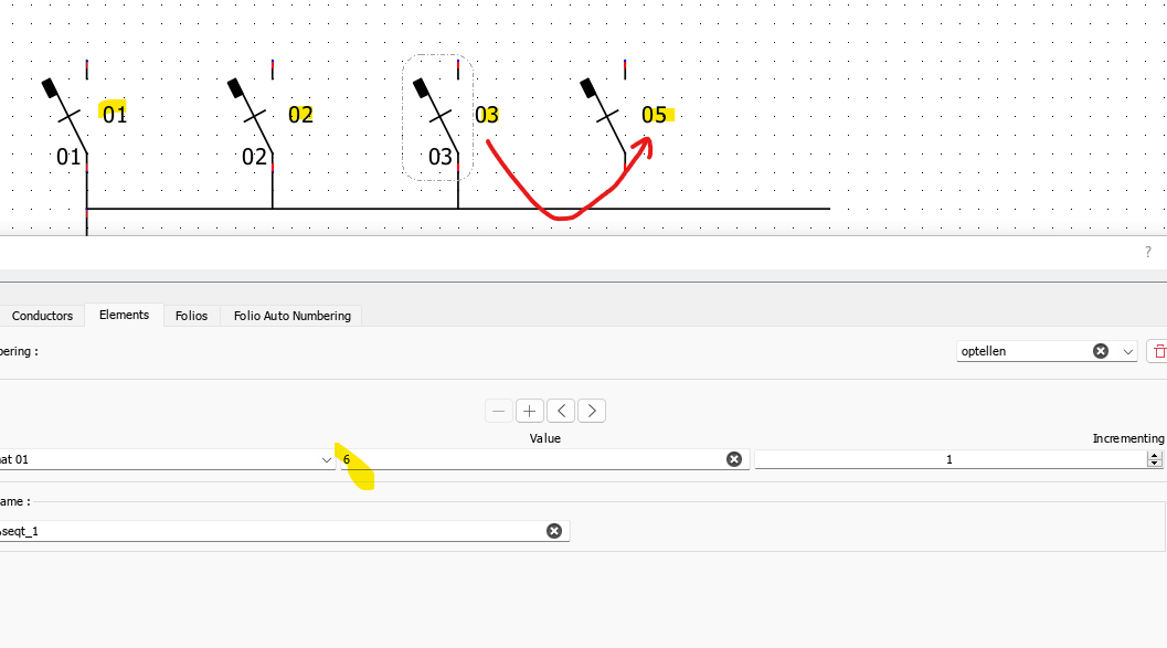

Using numbers... when I make a simple sequence and incrementing it by 1. And then I for some reason I delete an element. And place another element instead with the same autonumbering I get this... See screenshot.
The value itself is being changed.
Is that a bug or a feature? And could I make it hounor my formula?
It's not a bug it's a feature nomicons/grin .
Seriously, the autonumbering don't take count of deleted element, and so by consequence the numbering stay at the same state and cause the gap you describe in your screenshot
