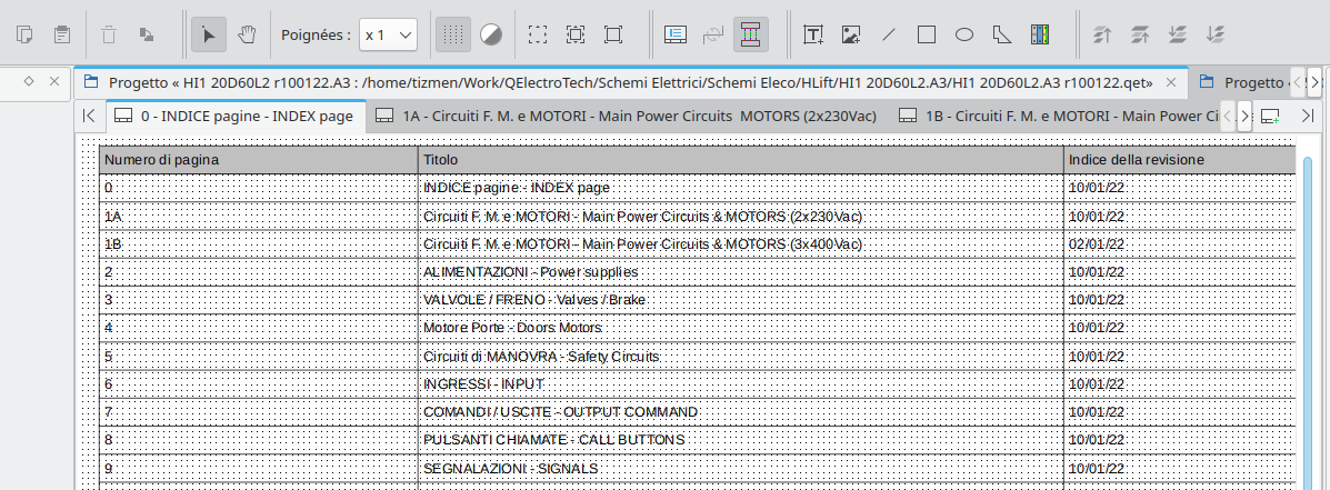

Hello,
I'm asking how can I bind two references on a single element referencing the previous/next sheet (e.g. 01coming_arrow).
Let me explain, sometimes it is necessary to provide 2 very similar diagrams where a module or for example the type of single-phase/three-phase motor changes.
In my case, the system provides for the possibility of using a 230Vac single-phase motor (small powers) or a 400Vac three-phase motor for higher powers.
In the sheet list I have therefore divided sheet (1) into (1A) (with single-phase motor) and (1B) (with three-phase motor).
Placing them both on the same sheet is not possible because it would create confusion and impossibility in the connections, for example circuit breaker, circuit breaker etc.
All the other sheets (e.g. 20) remain the same, therefore creating a different scheme code is harmful because for a subsequent change, for example to sheet "10" I MUST remember to do it AT THE SAME TIME also on the other scheme.
Create two separate labels on 01coming_arrow or 02going_arrow?
Thank you.
Schermata 2023-01-19 alle 14.48.24.png, 119.79 kb, 1197 x 441
