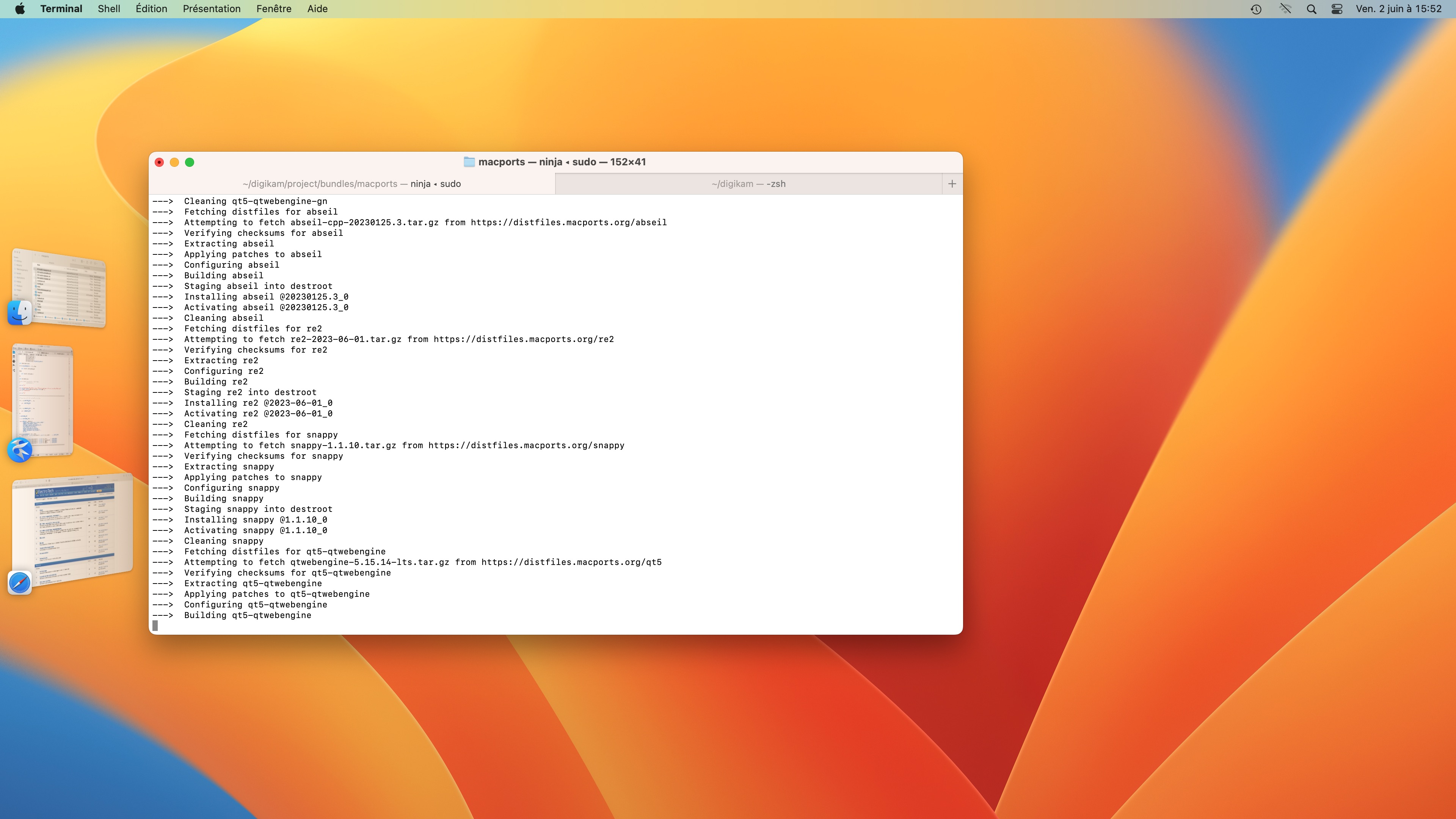

Re: Financing macOS machine for improving QElectroTech on MAC M1/M2 arm64
Yippee...

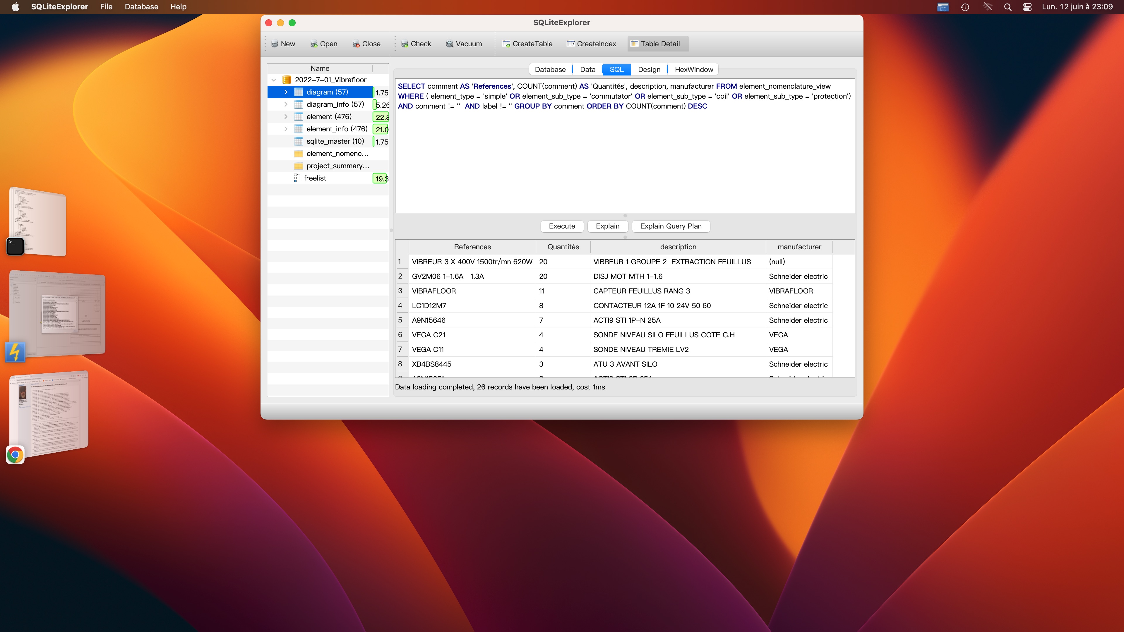

Fixed sqlite3 database export on Apple arm64 packages with Digikam scripts .
https://www.qt.io/blog/commercial-lts-q … 9-released
Qt 5.15.9 provides support for macOS on ARM, including prebuilt binaries for both single architecture and universal builds. Build system support for universal builds is limited to the qmake build system. See the Qt for macOS documentation for details on how to enable universal builds for your application.
F/opt/digikam.org.arm64/libexec/qt5/lib /opt/digikam.org.arm64/lib/libsqlite3.0.dylib -framework QtSvg -framework QtPrintSupport /opt/digikam.org.arm64/lib/libKF5WidgetsAddons.dylib -framework QtWidgets -framework QtGui -framework AppKit -framework Metal -framework QtNetwork -framework QtXml -framework QtSql -framework QtConcurrent /opt/digikam.org.arm64/lib/libKF5CoreAddons.dylib -framework QtCore -framework DiskArbitration -framework IOKit -framework OpenGL -framework AGL
ld: warning: dylib (/opt/digikam.org.arm64/libexec/qt5/lib/QtWidgets.framework/QtWidgets) was built for newer macOS version (11.3) than being linked (11.0)
ld: warning: dylib (/opt/digikam.org.arm64/libexec/qt5/lib/QtGui.framework/QtGui) was built for newer macOS version (11.3) than being linked (11.0)
ld: warning: dylib (/opt/digikam.org.arm64/lib/libKF5WidgetsAddons.dylib) was built for newer macOS version (11.3) than being linked (11.0)
ld: warning: dylib (/opt/digikam.org.arm64/libexec/qt5/lib/QtSvg.framework/QtSvg) was built for newer macOS version (11.3) than being linked (11.0)
ld: warning: dylib (/opt/digikam.org.arm64/libexec/qt5/lib/QtPrintSupport.framework/QtPrintSupport) was built for newer macOS version (11.3) than being linked (11.0)
ld: warning: dylib (/opt/digikam.org.arm64/lib/libsqlite3.0.dylib) was built for newer macOS version (11.3) than being linked (11.0)
ld: warning: dylib (/opt/digikam.org.arm64/libexec/qt5/lib/QtNetwork.framework/QtNetwork) was built for newer macOS version (11.3) than being linked (11.0)
ld: warning: dylib (/opt/digikam.org.arm64/libexec/qt5/lib/QtSql.framework/QtSql) was built for newer macOS version (11.3) than being linked (11.0)
ld: warning: dylib (/opt/digikam.org.arm64/libexec/qt5/lib/QtXml.framework/QtXml) was built for newer macOS version (11.3) than being linked (11.0)
ld: warning: dylib (/opt/digikam.org.arm64/lib/libKF5CoreAddons.dylib) was built for newer macOS version (11.3) than being linked (11.0)
ld: warning: dylib (/opt/digikam.org.arm64/libexec/qt5/lib/QtConcurrent.framework/QtConcurrent) was built for newer macOS version (11.3) than being linked (11.0)
ld: warning: dylib (/opt/digikam.org.arm64/libexec/qt5/lib/QtCore.framework/QtCore) was built for newer macOS version (11.3) than being linked (11.0)
The time of compilation is 1 min 10 sec
______________________________________________________________
Copy Qt libraries and private frameworks:
Processing Mac deployment tool...
Copy file missing:
Copying add elements in the bundle...
Copying titleblocks in the bundle...
Copying translations in the bundle...
Copying examples in the bundle...
qelectrotech.app: replacing existing signature
Create zip tarball:
Would you like to upload for Notarize packages qelectrotech-0.100.0-r7856-arm64.zip, n/Y?.
FYI, I just saw MacPorts ported Qt 5.15.9 and I retry again Digikam scripts with little hacks for build only arm64 (Apple silicon) packages for the moment.. QET build with universal compile ok, but QET crash on launch ... So need to hack again Digikam and compile many hours again only arch: arm64......
I will see later...for universal....

Attachment icon Capture d’écran 2023-06-02 à 15.52.04.jpeg 761.09 kb, 360 downloads since 2023-06-02
Humm- Well fail after 5 at 6 hours of compile... first script...01
CMakeFiles/breeze-validate-svg.dir/build.make:71: CMakeFiles/breeze-validate-svg] Error 1
CMakeFiles/Makefile2:248: CMakeFiles/breeze-validate-svg.dir/all] Error 2
laurent@mini-de-laurent macports %  ./02-build-extralibs.sh
Password:
02-build-extralibs.sh : build extra libraries using MacPorts.
Mac mini M2 8Gb 256G SSD:
./01-build-macports.sh take +-5 hours --> ext_libjxl fail to build so disabled and 01 compile ok
./02-build-extralibs.sh. take 0 hours 5 minutes 5 seconds --> ext_breeze-icons fail to build so disabled and 02 compile ok
diff --git a/project/bundles/macports/01-build-macports.sh b/project/bundles/macports/01-build-macports.sh
index c9593b8f6f..8521404ae2 100755
--- a/project/bundles/macports/01-build-macports.sh
+++ b/project/bundles/macports/01-build-macports.sh
@@ -210,7 +210,7 @@ EOF
         # No need to build with both architectures embeded (x86 and ARM) for Apple Silicon target
         cat << EOF >> "$INSTALL_PREFIX/etc/macports/variants.conf"
-+universal
++arm64
EOF
     fi
@@ -370,7 +370,7 @@ fi
cmake --build . --config RelWithDebInfo --target ext_opencv      -- -j$CPU_CORES
cmake --build . --config RelWithDebInfo --target ext_imagemagick -- -j$CPU_CORES
-cmake --build . --config RelWithDebInfo --target ext_libjxl      -- -j$CPU_CORES
+#cmake --build . --config RelWithDebInfo --target ext_libjxl      -- -j$CPU_CORES
cmake --build . --config RelWithDebInfo --target ext_libavif     -- -j$CPU_CORES
diff --git a/project/bundles/macports/02-build-extralibs.sh b/project/bundles/macports/02-build-extralibs.sh
index ffad309c19..c71c473278 100755
--- a/project/bundles/macports/02-build-extralibs.sh
+++ b/project/bundles/macports/02-build-extralibs.sh
@@ -77,7 +77,7 @@ cmake $ORIG_WD/../3rdparty \
# core KF5 frameworks dependencies
cmake --build . --config RelWithDebInfo --target ext_extra-cmake-modules -- -j$CPU_CORES
cmake --build . --config RelWithDebInfo --target ext_kconfig             -- -j$CPU_CORES
-cmake --build . --config RelWithDebInfo --target ext_breeze-icons        -- -j$CPU_CORES
+#cmake --build . --config RelWithDebInfo --target ext_breeze-icons        -- -j$CPU_CORES
cmake --build . --config RelWithDebInfo --target ext_kcoreaddons         -- -j$CPU_CORES
cmake --build . --config RelWithDebInfo --target ext_kwindowsystem       -- -j$CPU_CORES
cmake --build . --config RelWithDebInfo --target ext_solid               -- -j$CPU_CORES
diff --git a/project/bundles/macports/config.sh b/project/bundles/macports/config.sh
index 830ac93ed5..d84dc30231 100644
--- a/project/bundles/macports/config.sh
+++ b/project/bundles/macports/config.sh
@@ -16,7 +16,7 @@ BUILDING_DIR="`pwd`/temp.build"
# Target macOS architecture: "x86_64" for Intel 64 bits, or "arm64" for Apple Silicon 64 bits.
-ARCH_TARGET="x86_64"
+ARCH_TARGET="arm64"
if [[ $ARCH_TARGET = "x86_64" ]] ; then
@@ -50,7 +50,7 @@ if [[ $ARCH_TARGET = "x86_64" ]] ; then
elif [[ $ARCH_TARGET = "arm64" ]] ; then
     # Apple Silicon is supported since macOS BigSur
-    OSX_MIN_TARGET="11.0"
+    OSX_MIN_TARGET="11.3"
else
