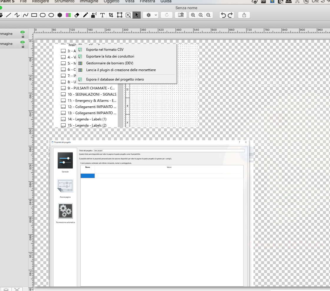

Topic: Export the project database and import it for the new project.
The new project is empty.
Project database export is only on Windows, there is no Mac!
If I export the database of an existing project (fields adapted to the title block) with Windows, how can I import it into a new empty project?
Schermata 2022-12-16 alle 17.51.57.png, 242.68 kb, 1121 x 986

I have already spent many days working on it without result.
On macOS is very difficult to add sqlite3 dependancy in the QET package, see :
https://qelectrotech.org/wiki_new/roadmap#todo
Re: Export the project database and import it for the new project.
No...it's not worth it..
I take the data from the previous project and copy it to the new one.
I used KDE for a while and I also liked it as a better manageable graphics than Ubuntu.
Unfortunately we are linked to the operating systems used by most of the suppliers of "technical" type software such as Cad Pcb, or uC firmware development tools (eg Keil).
Almost always on S.O. Windows and rarely macOS which would be more stable...
thanks anyway..

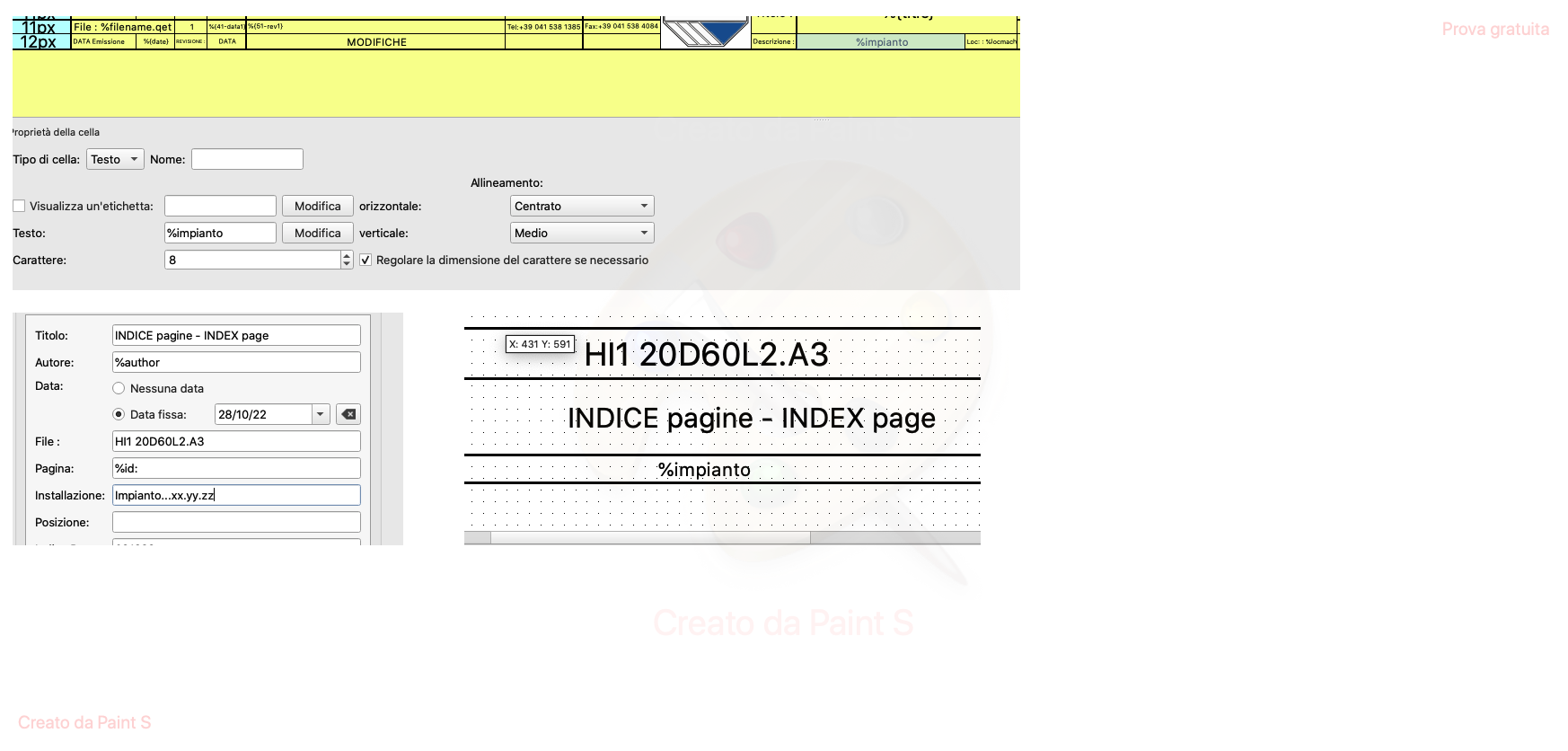

Lorenzo,
Can you tell me why the %impianto link doesn't work?
Translation problems?
I also tried in other languages "plant or machine" but nothing.
Thank you.
Senza nome 2.png, 270.5 kb, 1746 x 836
