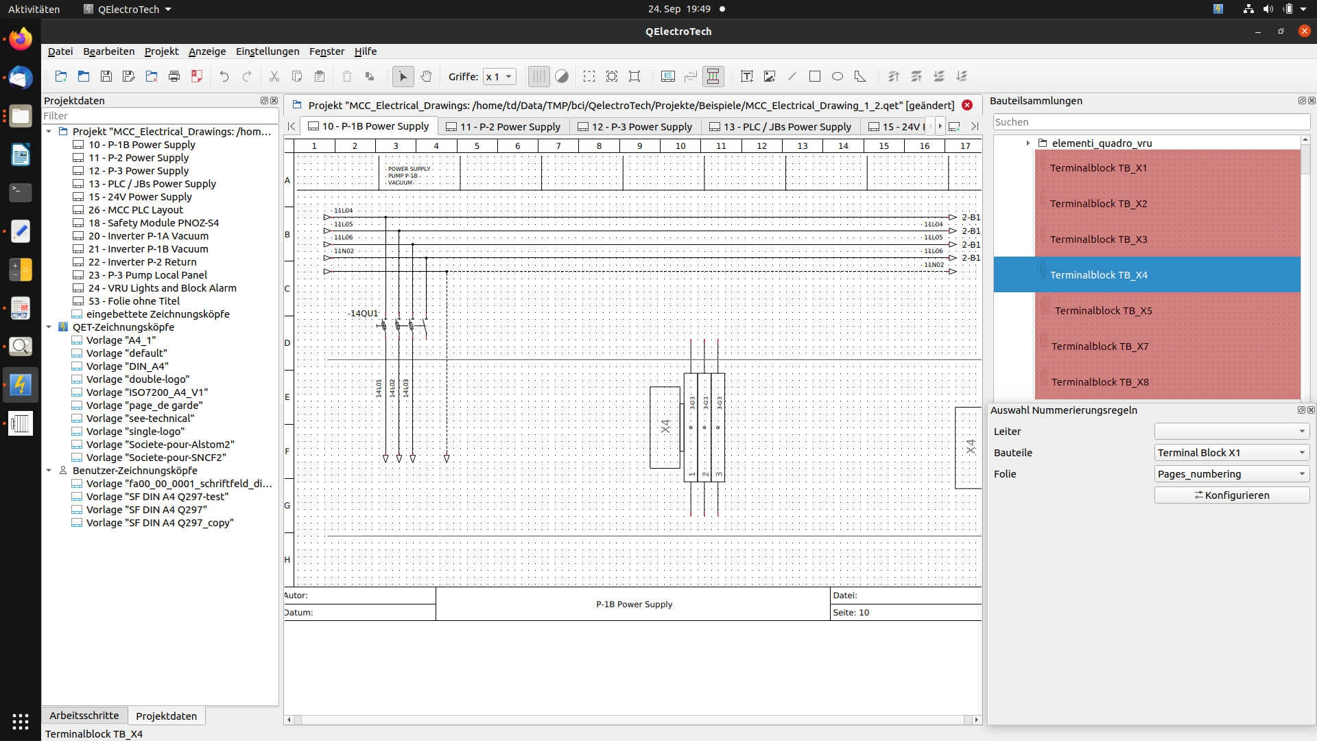

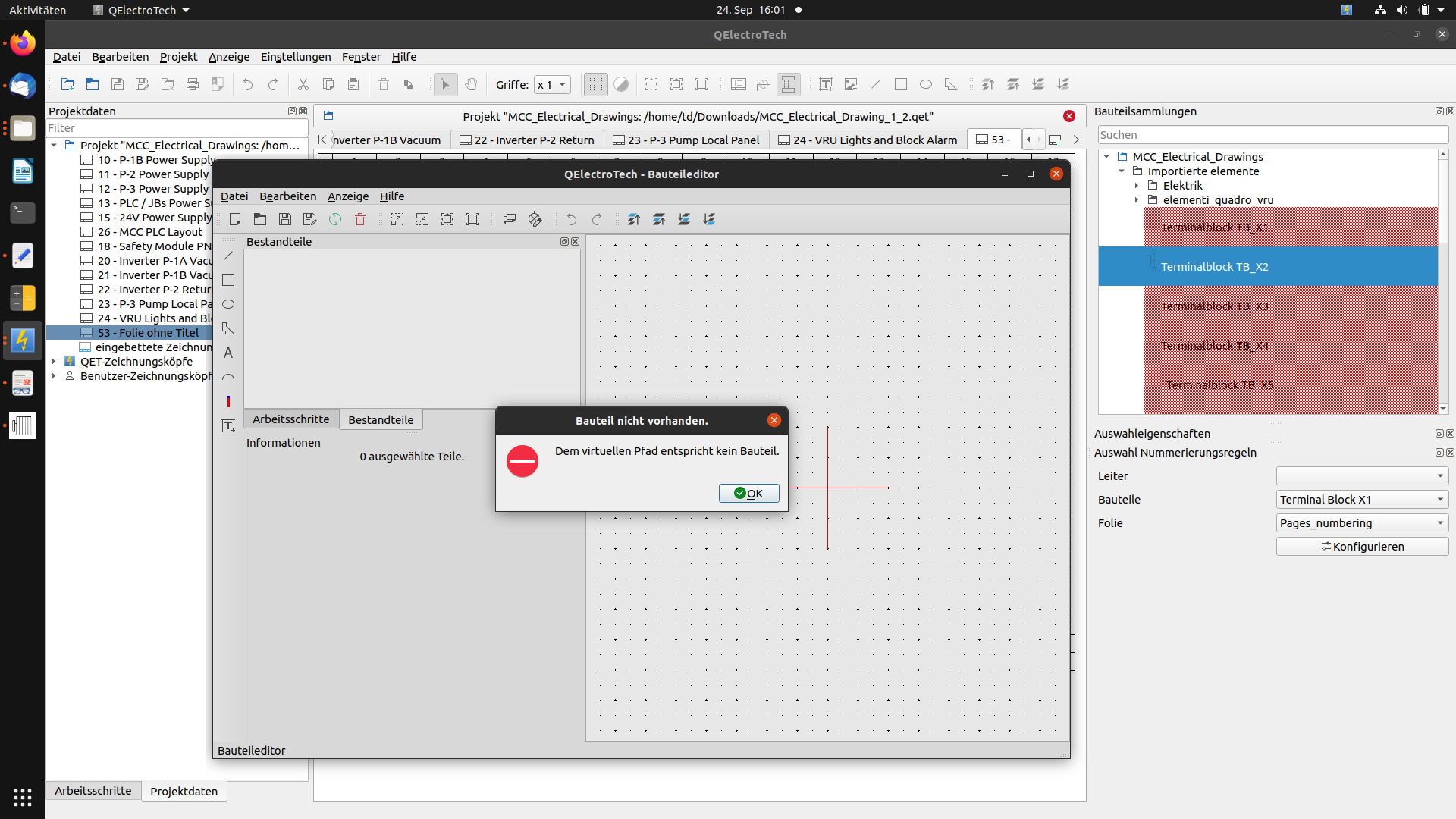

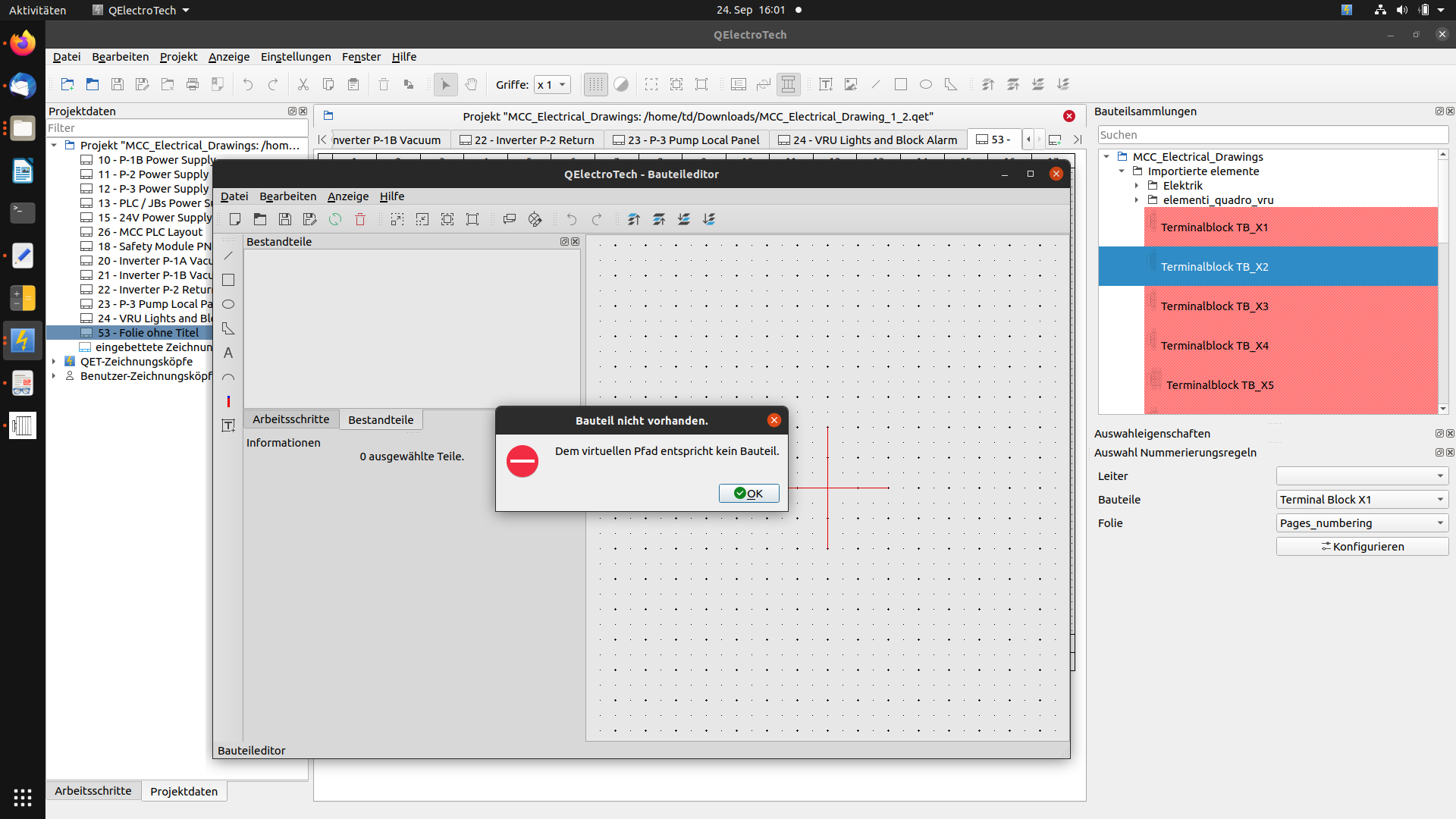

Bildschirmfoto von 2022-09-24 16-01-34.png, 241.93 kb, 1920 x 1080

Google says:
"no component corresponds to the virtual path"
Now it works
"project2+embed://import/TB_X3.elmt"

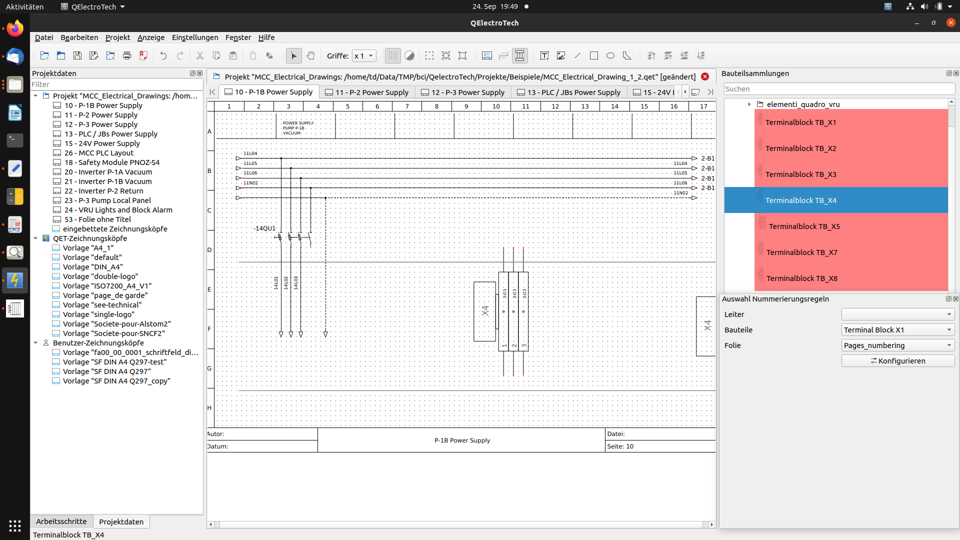

Bildschirmfoto von 2022-09-24 19-49-54.png, 295.81 kb, 1920 x 1080
Re: generated terminals are empty
tried other projects.
every TB is working again.
I've no explanation for this behaviour
