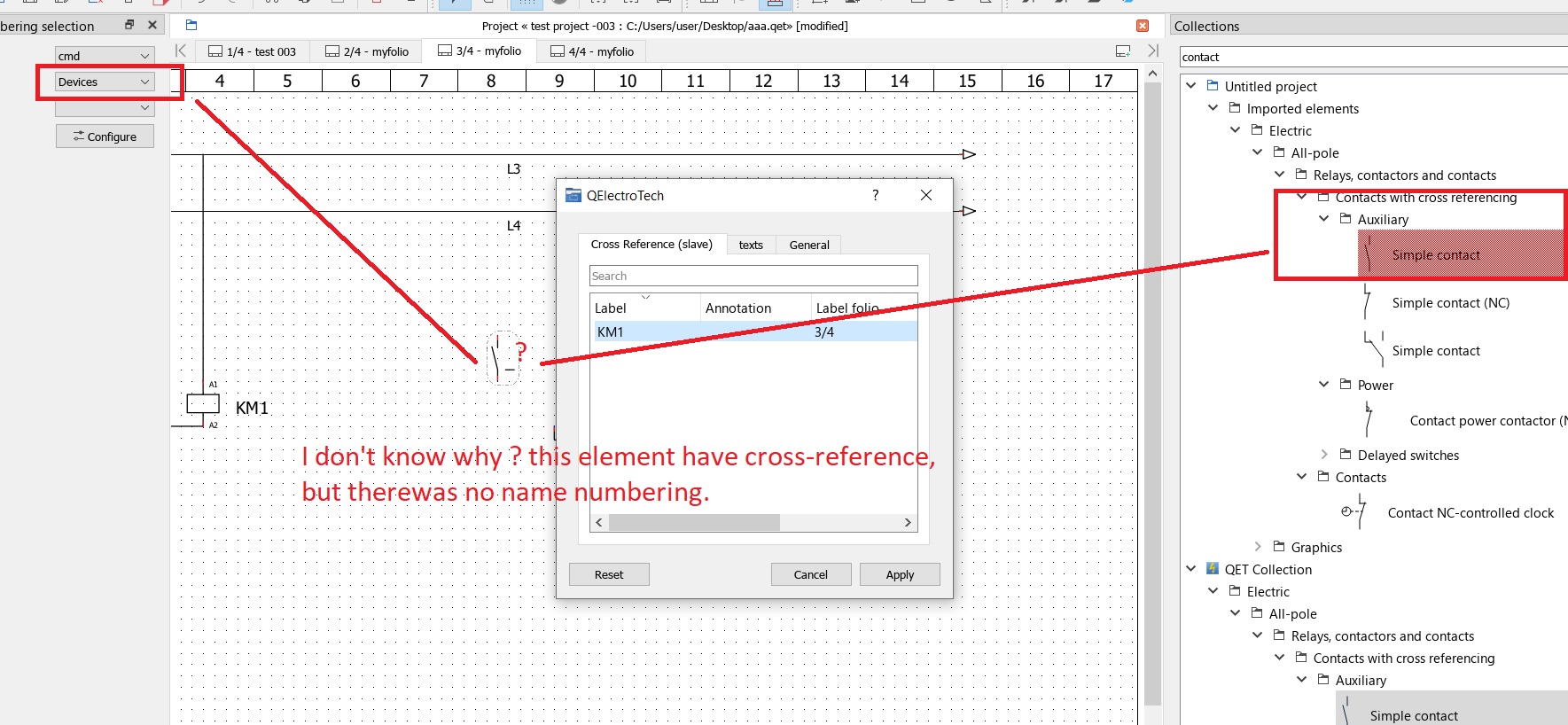

Could you please help us how to use the element with cross-reference and auto name numbering.
I don't know why ?---> this element have cross-reference, but therewas no auto name numbering. as Pic.1
And I don't know why ?---> some element there was auto name numbering, but there was no cross-reference. as Pic.2
Pleasesuggest us.

KM1 is not connected with the contact. Make right-click to KM1 in the dialog-window and link the item

achim wrote:
picture 1
Thanks for your kindness,
Actually I knew that the element in pic.1 can be cross reference then I need this element to be the auto-name numbering, too
If you see the picture there was no name element with auto numbering.
Could you please help us to make element in pic.1 go in auto name numbering.
On the other hands, as in pic.2 you will see the element can be auto-name numbering but there was no cross reference!!!
I didn't know why?
Please help us to make the element cross-reference with auto-numbering.
Re: Please help us to make the element cross-reference with auto-numbering
The auto-name numbering is for master element, not for slave contact, etc.
