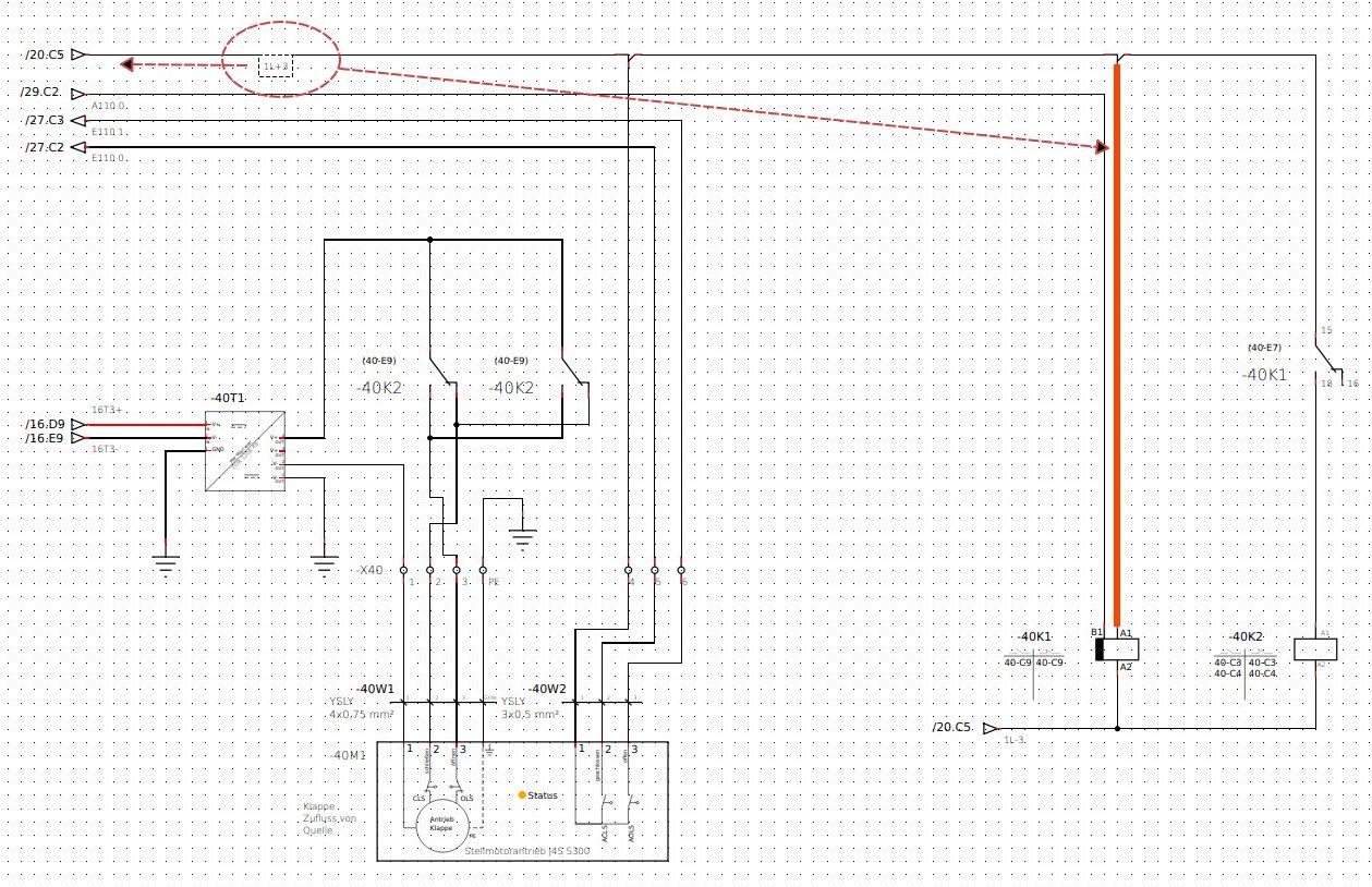

is there a way that a wire's name can be moved to any position on the page?
In some cases this is currently prevented and the color of the wire is shown in red.
Thanks

Yes it is normal I think your jump is not a terminal property and breaks equipotentiality.
Please send this example.

Hallo scorpio810,
here is a small example.
Thanks for the help!

We have in the past allowed more than once the distance from the text and increase the distance, if you increase it too much it doesn't make sense anymore.
