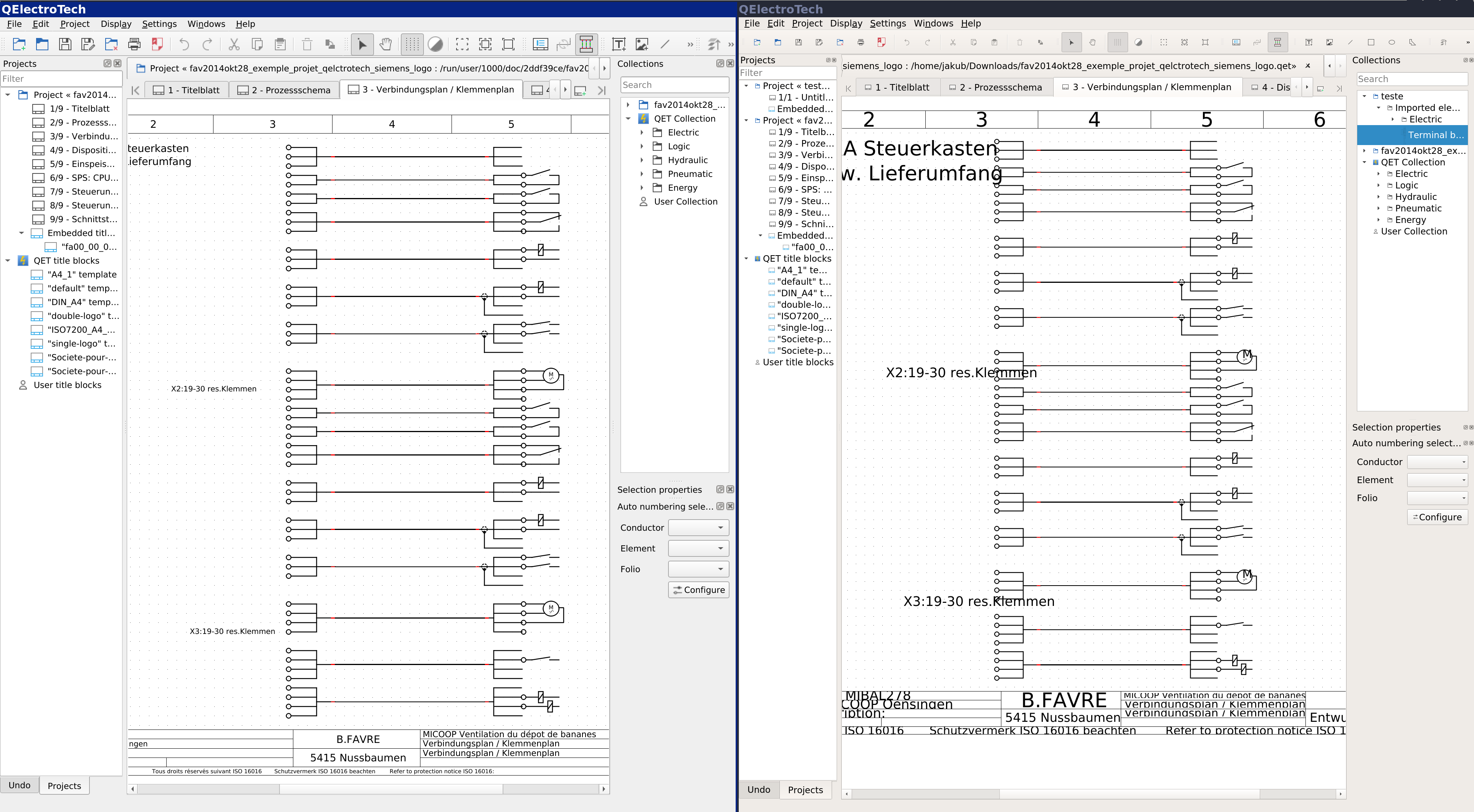

Dear QET Developers and Users,
EDIT: this is my individual PC setup problem
It looks like my unusual GNU/Linux setup (Ubuntu 18./04 and i3 window manager) is causing some unwanted display behaviour whenever I start the recent PPA build. When I use regular desktop environment instead i3, everything is good for both PPA and Snap. Do you have any idea what could be responsible for these issues? It feels to me that there is some scaling issue.
Original post:
I have just tried recent snap and ppa packages, both for version 0.9.
It looks like QET from the snap package (left image) displays QET projects from version 0.8 much better than the recent ppa build.
What might be causing the difference and how to fix that?
Snap Installation:
QElectroTech V 0.9-dev-156-gc1fdc1ada.snap
Compilation : GCC 7.5.0
Built with Qt 5.12.3 - Date : May 15 2021 : 17:57:00
Run with Qt 5.12.3 using 12 thread(s)
CPU : model name : Intel(R) Core(TM) i7-8750H CPU @ 2.20GHz
RAM Total : 31636 MB
RAM Available : 19288 MB
GPU :
GPU RAM : @ToDo
OS : linux - x86_64 - Version : Ubuntu Core 18 - Kernel : 5.3.0-22-generic
*** Qt screens ***
( 1 : 3840 x 2160 )
PPA Installation:
QElectroTech V 0.90-DEV+c1fdc1adac957a06d79751d3
Built with Qt 5.9.5 - Date : May 15 2021 : 20:03:54
Run with Qt 5.9.5 using 12 thread(s)
RAM Available : 19121 MB
GPU : NVIDIA Corporation GP107M [GeForce GTX 1050 Ti Mobile] (rev a1)
GPU RAM : @ToDo
OS : linux - x86_64 - Version : Pop!_OS 18.04 LTS - Kernel : 5.3.0-22-generic
*** Qt screens ***
( 1 : 3840 x 2160 )
Thank you for your time and consideration
Regards,
Jakub
Re: Individual, setup-dependent differences:snap an ppa packages [ver 0.9]
Snap Installation:
PPA Installation:
If you want new Qt libs version upgrade your Ubuntu version to latest.
or use AppImage.
