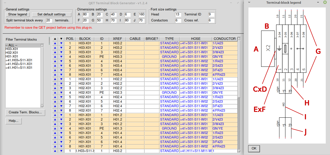

The version 1.2.4 is available.
How install/upgrade from pip packages
Requires python 3.5 or above.
>> First install on Linux (Debian based distros)
1. In a terminalm install python3 and GUI library:
    sudo apt-get install python3 python3-tk python3-pip
2. Install the program:
    sudo pip3 install qet_tb_generator
3. Launch the plugin from the 'Project' menu of QElectrotech.
>> Update on Linux
sudo python3 -m pip install --upgrade qet_tb_generator
>> First install on Windows
1. Install, if required, python 3.5 or above
2. pip3 install qet_tb_generator
>> Update on Windows
python -m pip install --upgrade qet_tb_generator
Screenshot v1.2.4.png, 180.69 kb, 1323 x 622

Thanks Unalcalde.
I packaged qet_tb_generator for debian and Ubuntu PPA, but
qet_tb_generator
  File "/usr/local/bin/qet_tb_generator", line 5, in <module>
    from src.main import main
  File "/usr/lib/python3/dist-packages/src/main.py", line 98, in <module>
    import PySimpleGUI as sg
ModuleNotFoundError: No module named 'PySimpleGUI'
We need to install PySimpleGUI by pip3, because no Debian package and no libs are available now.
[11:34:22] laurent@debian:~$ pip3 install --upgrade PySimpleGUI
Collecting PySimpleGUI
  Downloading PySimpleGUI-4.41.2-py3-none-any.whl (348 kB)
     |████████████████████████████████| 348 kB 2.1 MB/s
Installing collected packages: PySimpleGUI

11:44:27 DEBUG    Getting cable number connected to terminal 52 at page V6 Gate Control Circuit [qetproject._getCableNum:266]
11:44:27 DEBUG    Cols: 18      Col size: 60    Row size: 80    X position: 350 Y Position: 500 [qetproject._getXRefByCoord:351]
11:44:27 DEBUG    Getting cable number connected to terminal 86 at page V6 Gate Control Circuit [qetproject._getCableNum:266]
11:44:27 DEBUG    Getting cable number connected to terminal 87 at page V6 Gate Control Circuit [qetproject._getCableNum:266]
11:44:27 DEBUG    Cols: 18      Col size: 60    Row size: 80    X position: 140 Y Position: 270 [qetproject._getXRefByCoord:351]
11:44:27 DEBUG    Getting cable number connected to terminal 12 at page V7 Gate Control Circuit [qetproject._getCableNum:266]
11:44:27 DEBUG    Getting cable number connected to terminal 13 at page V7 Gate Control Circuit [qetproject._getCableNum:266]
11:44:27 DEBUG    Cols: 18      Col size: 60    Row size: 80    X position: 960 Y Position: 200 [qetproject._getXRefByCoord:351]
11:44:27 DEBUG    Getting cable number connected to terminal 14 at page V7 Gate Control Circuit [qetproject._getCableNum:266]
11:44:27 DEBUG    Getting cable number connected to terminal 15 at page V7 Gate Control Circuit [qetproject._getCableNum:266]
11:44:27 DEBUG    Getting cable number connected to terminal 17 at page V7 Gate Control Circuit [qetproject._getCableNum:266]
11:44:27 DEBUG    Getting cable number connected to terminal 18 at page V7 Gate Control Circuit [qetproject._getCableNum:266]
11:44:27 DEBUG    Cols: 18      Col size: 60    Row size: 80    X position: 1010        Y Position: 500 [qetproject._getXRefByCoord:351]
11:44:27 DEBUG    Getting cable number connected to terminal 25 at page V7 Gate Control Circuit [qetproject._getCableNum:266]
11:44:27 DEBUG    Getting cable number connected to terminal 26 at page V7 Gate Control Circuit [qetproject._getCableNum:266]
11:44:27 DEBUG    Cols: 18      Col size: 60    Row size: 80    X position: 760 Y Position: 500 [qetproject._getXRefByCoord:351]
11:44:27 DEBUG    Getting cable number connected to terminal 27 at page V7 Gate Control Circuit [qetproject._getCableNum:266]
11:44:27 DEBUG    Getting cable number connected to terminal 28 at page V7 Gate Control Circuit [qetproject._getCableNum:266]
11:44:27 DEBUG    Getting cable number connected to terminal 31 at page V7 Gate Control Circuit [qetproject._getCableNum:266]
11:44:27 DEBUG    Getting cable number connected to terminal 32 at page V7 Gate Control Circuit [qetproject._getCableNum:266]
11:44:27 DEBUG    Cols: 18      Col size: 60    Row size: 80    X position: 760 Y Position: 200 [qetproject._getXRefByCoord:351]
11:44:27 DEBUG    Getting cable number connected to terminal 34 at page V7 Gate Control Circuit [qetproject._getCableNum:266]
11:44:27 DEBUG    Getting cable number connected to terminal 35 at page V7 Gate Control Circuit [qetproject._getCableNum:266]
11:44:27 DEBUG    Cols: 18      Col size: 60    Row size: 80    X position: 300 Y Position: 500 [qetproject._getXRefByCoord:351]
11:44:27 DEBUG    Getting cable number connected to terminal 36 at page V7 Gate Control Circuit [qetproject._getCableNum:266]
11:44:27 DEBUG    Getting cable number connected to terminal 37 at page V7 Gate Control Circuit [qetproject._getCableNum:266]
11:44:27 DEBUG    Cols: 18      Col size: 60    Row size: 80    X position: 710 Y Position: 200 [qetproject._getXRefByCoord:351]
11:44:27 DEBUG    Getting cable number connected to terminal 39 at page V7 Gate Control Circuit [qetproject._getCableNum:266]
11:44:27 DEBUG    Getting cable number connected to terminal 40 at page V7 Gate Control Circuit [qetproject._getCableNum:266]
11:44:27 DEBUG    Cols: 18      Col size: 60    Row size: 80    X position: 120 Y Position: 270 [qetproject._getXRefByCoord:351]
11:44:27 DEBUG    Getting cable number connected to terminal 43 at page V7 Gate Control Circuit [qetproject._getCableNum:266]
11:44:27 DEBUG    Getting cable number connected to terminal 44 at page V7 Gate Control Circuit [qetproject._getCableNum:266]
11:44:27 DEBUG    Cols: 18      Col size: 60    Row size: 80    X position: 860 Y Position: 200 [qetproject._getXRefByCoord:351]
11:44:27 DEBUG    Getting cable number connected to terminal 45 at page V7 Gate Control Circuit [qetproject._getCableNum:266]
11:44:27 DEBUG    Getting cable number connected to terminal 46 at page V7 Gate Control Circuit [qetproject._getCableNum:266]
11:44:27 DEBUG    Cols: 18      Col size: 60    Row size: 80    X position: 100 Y Position: 270 [qetproject._getXRefByCoord:351]
11:44:27 DEBUG    Getting cable number connected to terminal 47 at page V7 Gate Control Circuit [qetproject._getCableNum:266]
11:44:27 DEBUG    Getting cable number connected to terminal 48 at page V7 Gate Control Circuit [qetproject._getCableNum:266]
11:44:27 DEBUG    Cols: 18      Col size: 60    Row size: 80    X position: 660 Y Position: 500 [qetproject._getXRefByCoord:351]
11:44:27 INFO     Deleted temp file /tmp/tmp3ho96a4v [qetproject.__init__:141]
  File "/usr/local/bin/qet_tb_generator", line 8, in <module>
    sys.exit(main())
  File "/usr/lib/python3/dist-packages/src/main.py", line 870, in main
    load_settings(window)
  File "/usr/lib/python3/dist-packages/src/main.py", line 623, in load_settings
    set_default_settings()
TypeError: set_default_settings() missing 1 required positional argument: 'window'

Re: New version available (1.2.4)
For now if you want 1.17 version on Debian, Ubuntu use this after remove my debian qet_tb_generator-1.2.4 deb package:
sudo pip3 install qet-tb-generator==1.1.7
time to find the bug

New version is available: 1.2.5
The problem was creating for the first time the settings file. I already had it created and I did not notice  about the error. Sorry.
    Portable versions at: https://github.com/raulroda/qet_tb_gene … aster/dist
    Source code: https://github.com/raulroda/qet_tb_generator-plugin
    The python pip3 package is also available:
