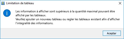

On a project I'm doing appears suddenly the attached message:
Of course it happens when I add a more components than I'm used  to,  but anyway not so much compard woth other project I saw
I'm confused about what to do with this
Can anyone help?

Re: "Limitation de tableau " message
You got this message when your project have a nomenclature.
This mean the nomenclature is full filled and can't display all element of your project.
To fix it you have two options:
-Remove the nomenclature and create a new one (It's better to add a nomenclature when you project is finished)
-Add a new (empty) nomenclature table and link this table to the last of your existing nomenclature.
To easily understand how work nomenclature :
-create a new empty project
-add an element
-add a nomenclature
-add several elements.
At each element you add in your folio, the nomenclature gain one line. When the nomenclature reach the bottom of the folio you will get the dialog. After that you can play with nomenclature to see what to do in this case.
Regards
