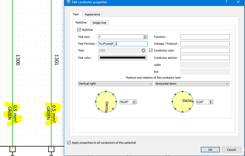

I'm trying to show conductor section and color in diagrams, but haven't found a way to get values from conductor properties, elements with terminals do not have such options to select as dynamic text, is there any usefulness filling properties in conductor?
And elements missing "Voltage/Protocol" property, is this removed intentionally, or by accident?

conductor.png, 37.19 kb, 937 x 597

No this feature doesn't exist.
It would be a good feature to add in future release.

did you read here?
https://qelectrotech.org/forum/viewtopi … 620#p19620
Not exactly what you mean, but the possibility to show the desired information in a schematic.
