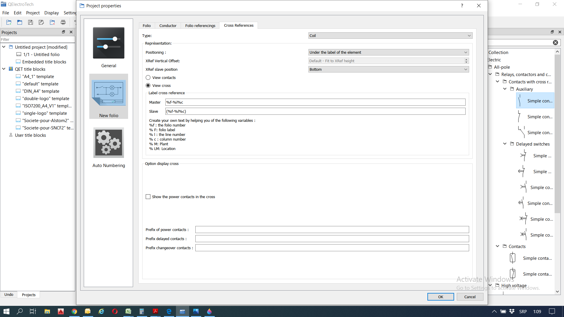

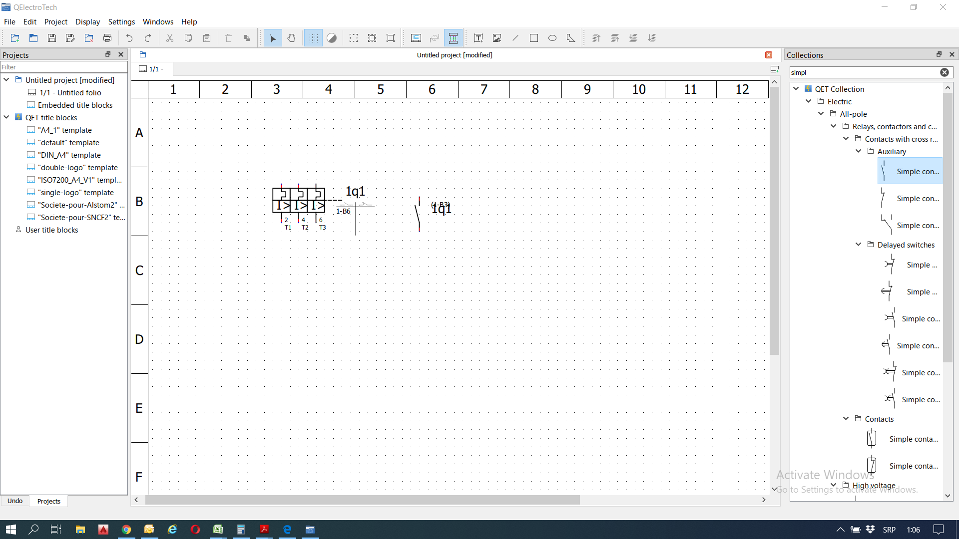

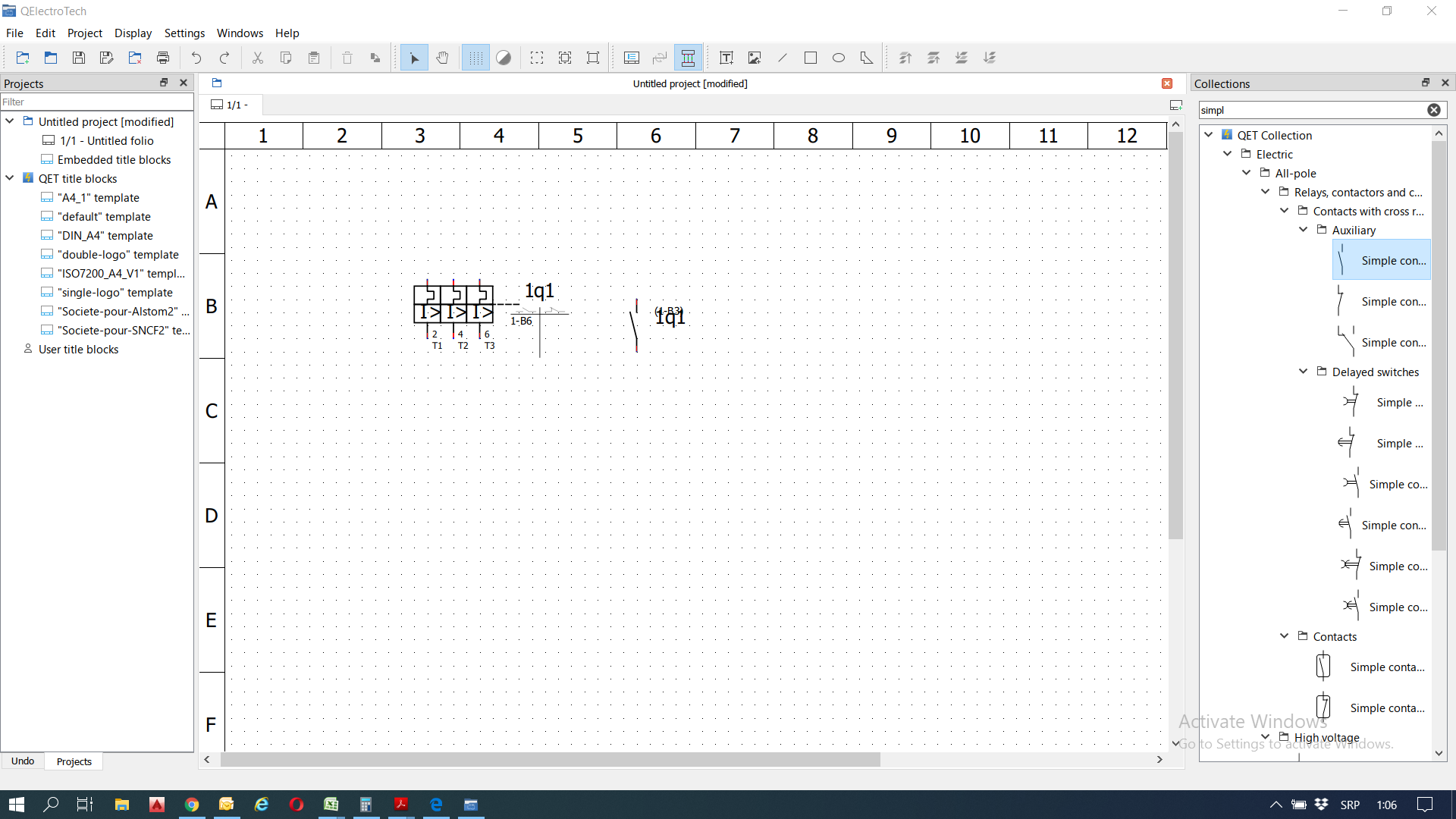

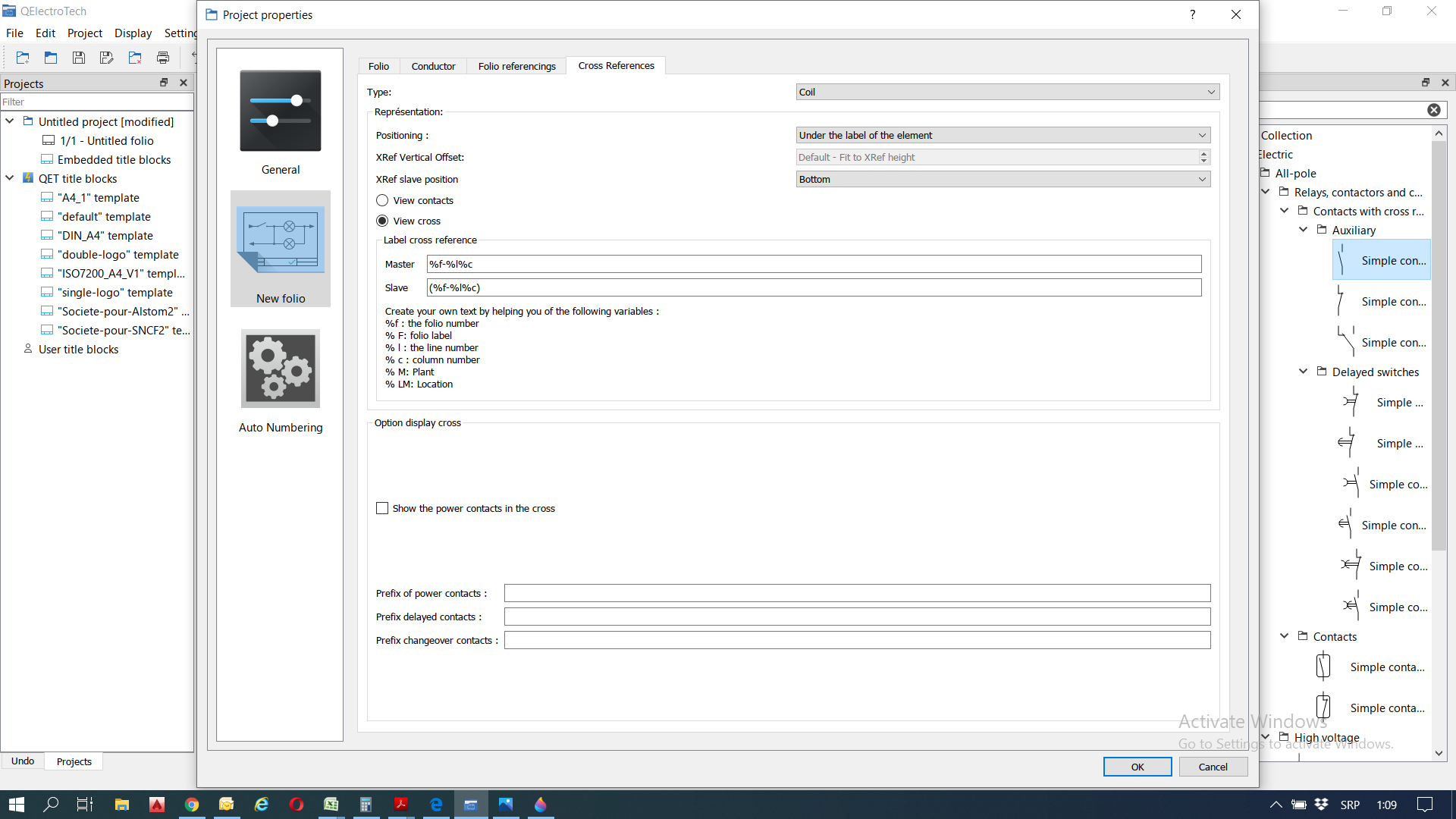

I have a problem with qelectrotech after installation on a new computer. The labels that you can see in the picture overlap. In the cross reference settings, everything is set up correctly. Does anyone know what the problem is?
Re: Cross references problem
I don't know if the image is uploaded
Untitled.png, 163.61 kb, 1920 x 1080

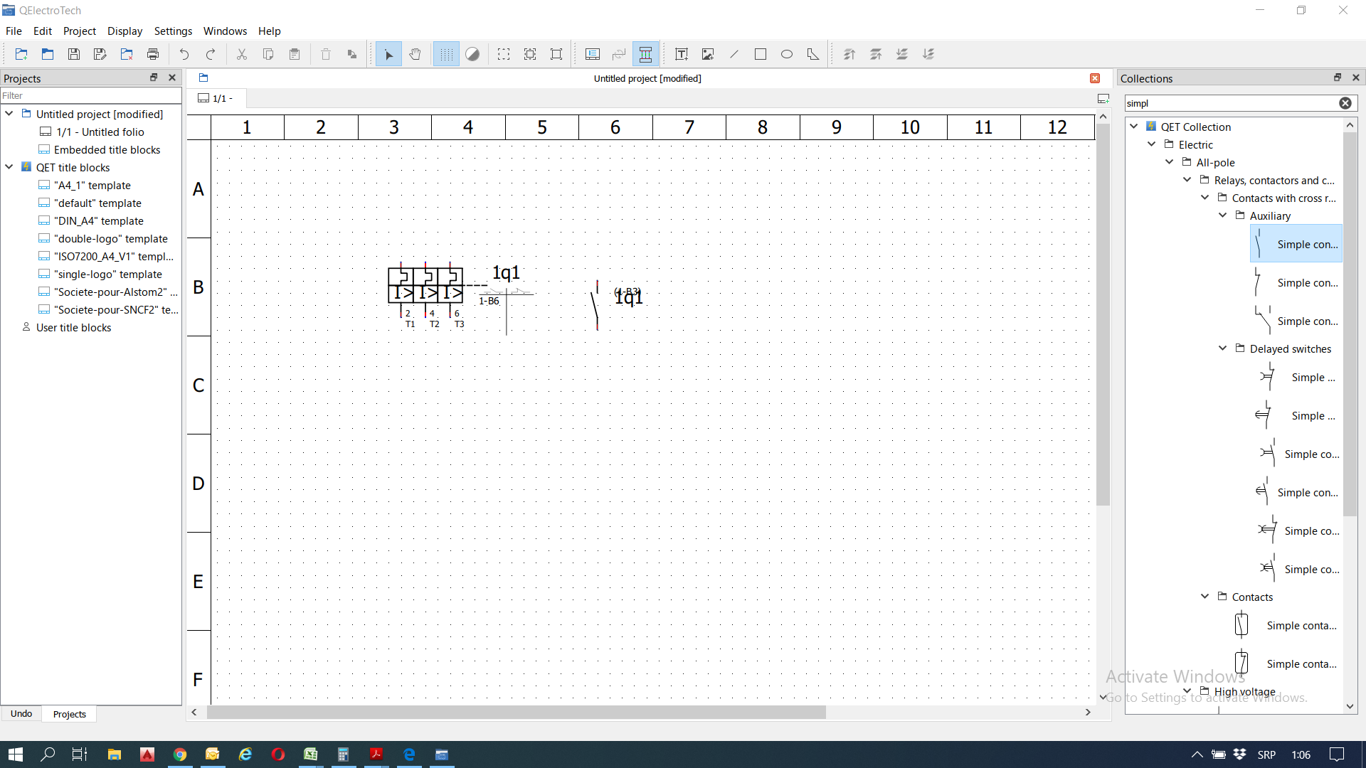

second picture
Untitled 1.png, 207.66 kb, 1920 x 1080

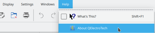

Good day, you can specify the version of QElectroTech?
Screenshot_20200802_103850.png, 13.9 kb, 647 x 141

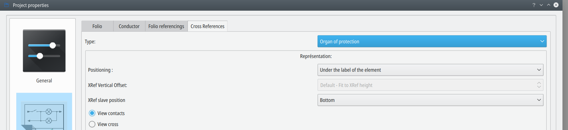

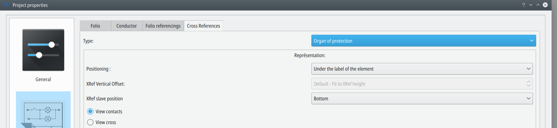

sale1970 wrote:
second picture
your contact on capture is not a slave Coil, but a slave of organ protection.
sale1970.png, 59.45 kb, 1850 x 426
Thank you. I did it
