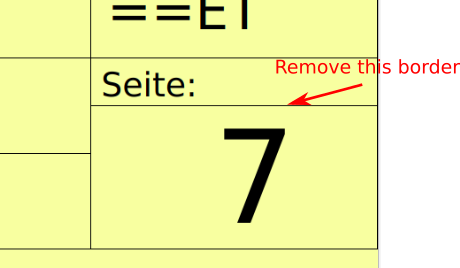

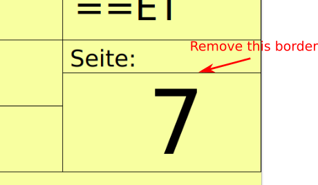

I am trying to build my own title block for a project and was wondering if there is a possibility to configure different cells without a border between them. Right now every cell seems always to be enclosed by a border.

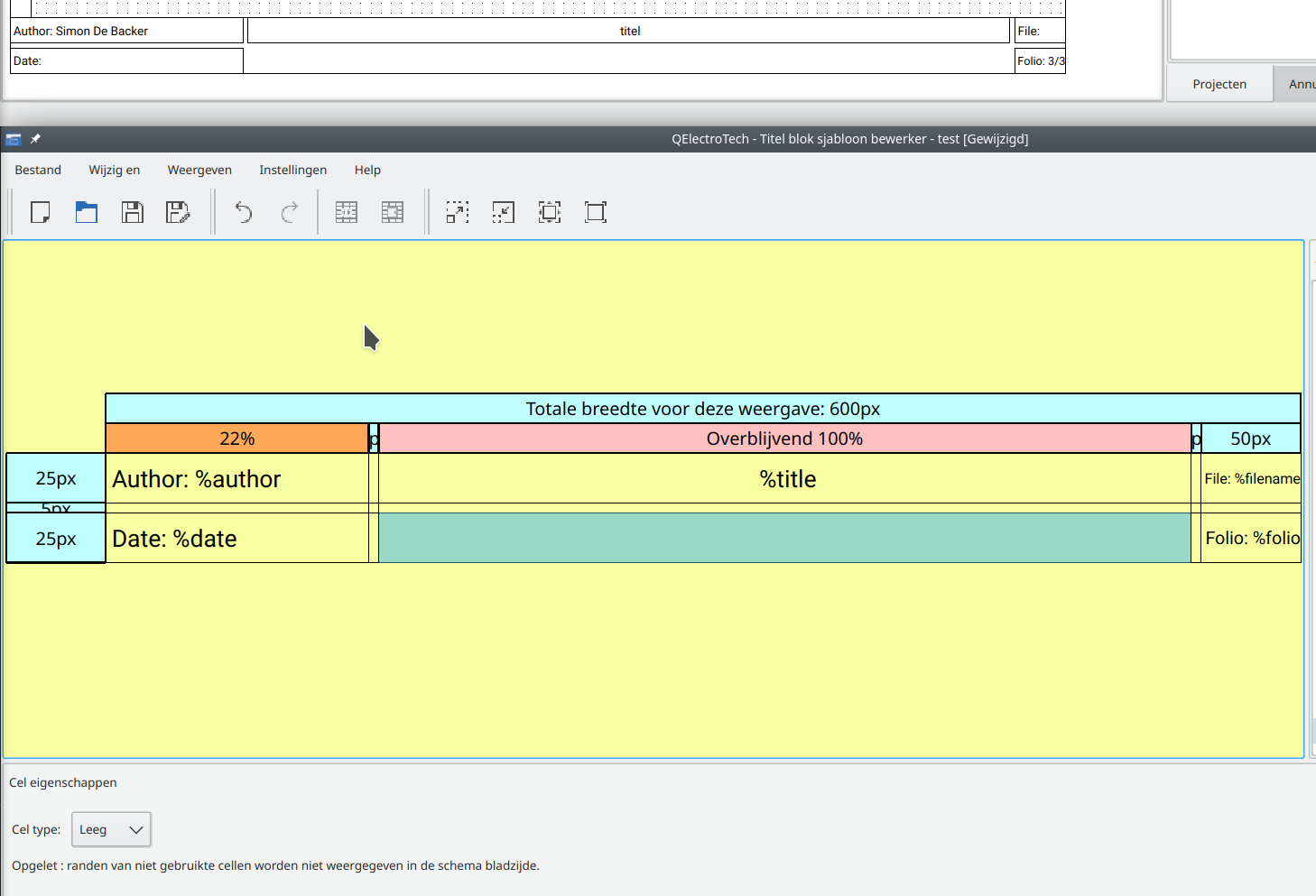

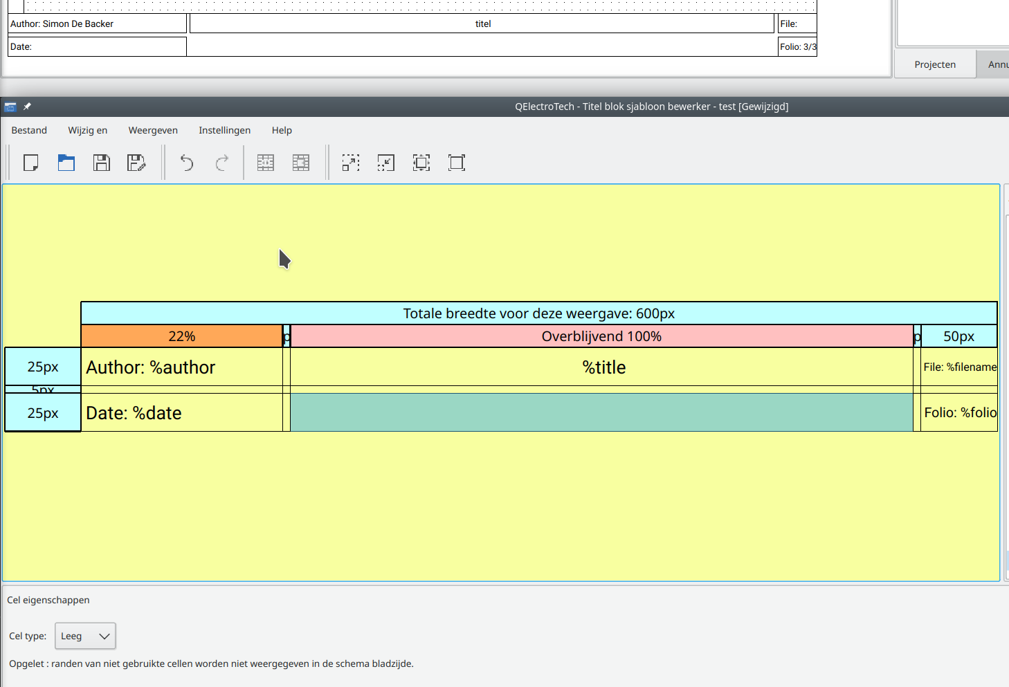

you mean this?
Screenshot.png, 80.63 kb, 1458 x 993

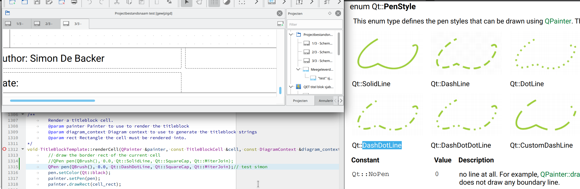

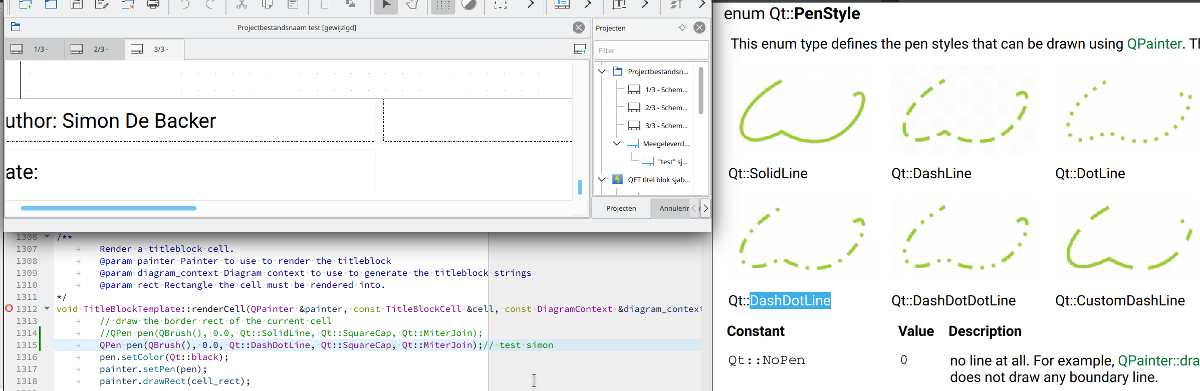

he is probably referring to the "renderCell"
titleblocktemplate.cpp@1312
test.png, 331.93 kb, 2395 x 781

es that seems to be the right location. I want to achieve 2 texts with different Text sizes and/or different alignments in the same cell.
bitmap.png, 12.28 kb, 460 x 268
