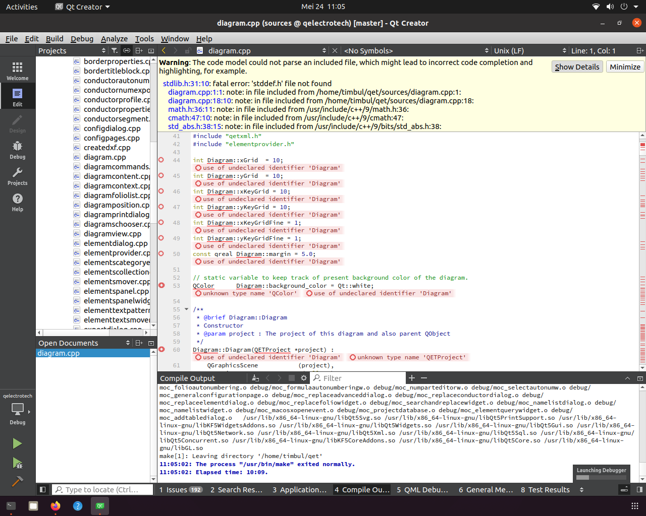

after install ubuntu 20.04LTS i install qtcreator
sudo apt-get install qtcreator git libkf5coreaddons-dev libkf5widgetsaddons-dev libqt5svg5-dev libkf5arcive-dev
compile successfully but there are warnings everywhere do I miss something?

maybe disable ClangCode Model in  about plug-in in your Qtcreator.
https://stackoverflow.com/questions/521 … luded-file
Re: install qtcreator on fresh install ubuntu 20.04
thank you @scorpio810, solved by disable ClangCodeModel
