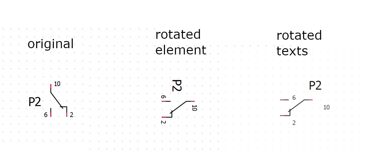

What happened to ,,do not rotate text with element" option? Now when I rotate my element, text is rotating with it and it really complicates things. Because of it I have to create vertical and horizontal version of many elements.
Is this is option hidden somewhere or is it not coming back?
I use released a few days ago 0.7 version of Qelectrotech.
Edit: Maybe changing the point of rotation (may I call it a hinge?) to the center of text? Then when I rotate the element, I will be able to easly rotate all the text withous changing it's position. Right now the point of rotation is upper-left corner of text and it's rotating around this point.
It's not necessary.
In the 0.7 version, the "dynamic text fields" have been added. You can set the angle of EVERY text of element as you want.
I think the option "do not rotate text with element" is either not been updated or outdated (because of the dynamic text fields).

I get the idea of dynamic text - I am a huge fan of that feature.
Nevertheless, If my element has a lot of text and I need to rotate it all, it all gets diplaced and I have to manually relocate it. See photo in attachment.
