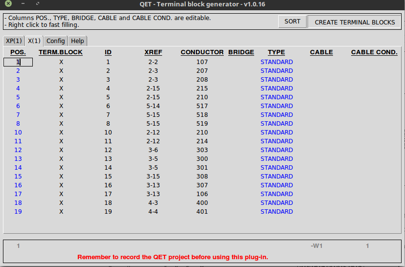

RTFM ...
See : help fied :
The terminals are sorted by default, however the order can be altered writing a value into the 'POS.' column.
Steps to use.
- In QET, save the project.
- Start the plugin. Choose 'Launch the terminal block creation plugin' in the project menu.
- Edit the terminal blocks (decribed below).
- Press the button 'CREATE TERMINAL BLOCKS' of the Plugin and returns to QET.
- Close the project discarding changes and reopen it.
- Under the 'COLLECTIONS' tree of the project, appears all terminal blocks.Considerations for creating a Terminal Block from a diagram.
- This plug-in searches for all elements of type 'Terminal'.
- Normally the terminal elements appears in the QET collection filtering by 'terminal block'.
- The terminals must have a label like <terminal_block_name>:<terminal_name>. For example: -X1:1, X34:+, X1:23, Y3:R,...
- All the terminals with the same <terminal_block_name> are grouped and are showed into a tab in this plug-in.
- If there are a lot of terminals, are splited into diferent terminal block (tabs) to fit in a diagram page.
- The terminals are sorted by default, however the order can be altered writing a value into the 'POS.' column.
- Also you can specify the cable and conductor that the terminal belongs (columns 'CABLE' and 'CABLE COND.').
- There are 3 types of terminals you can specify in the 'TYPE' column.
- The bridge column indicates a bridge from current to the next terminal.
How to use:
- To edit a cell, <Left click> in that cell.
- For faster filling, <Right click> in a cell, and auto-fills it with the value showed at the bottom of the colum.
- Pressing <Return> after editing a cell, refreshs the auto-fill.

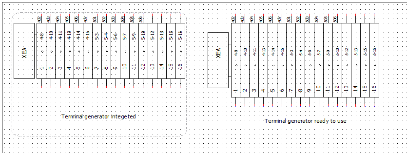

32 bits version (first link) works well ! Just someting strong : terminals are upper than the "integreted version". During use, there is one black window but it's not a problem.
Only double-click on exe to start terminal generator.
I didn't test 64 bits versions.
Thank you very much.
Nice, thanks !
But try the second link if you can, maybe it fix drawing size... (other VM and other Windows version but without visual studio code install).
It work but with the same problem of size.
Do you included it to the readytouse version ?
QET search pug-in in the Windows path. I think you need to edit "Lancer QET.bat" file on ReadyToUse and add plug-in PATH
https://stackoverflow.com/questions/739 … e-path-and
https://stackoverflow.com/questions/191 … er-changes
https://sumtips.com/how-to/create-short … n-windows/
I think no !
scorpio810 wrote:Salut,
essaye celui-ci : bundle Python35 32 bits win7 Win 10
Now, I have the same result of size on LM18 and the readytouse version. Terminals are upper than before: I think, script changed on last version.

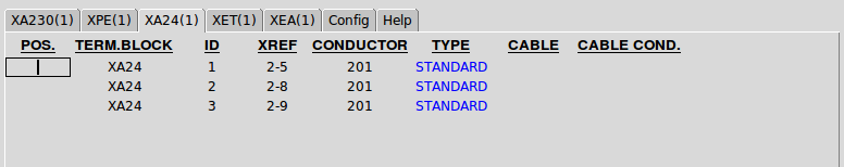

The terminal generator doesn't draw reserve ? How does it work ?
When I define "iD 10" on position 9, terminal generator doesn't create "reserve 9"....
The terminal generator doesn't draw reserve if terminals does not exists in your diagrams.
In older version you can rename reserve terminals free.
It work only if you create free terminal like "x:9" on your diagram, before running script.

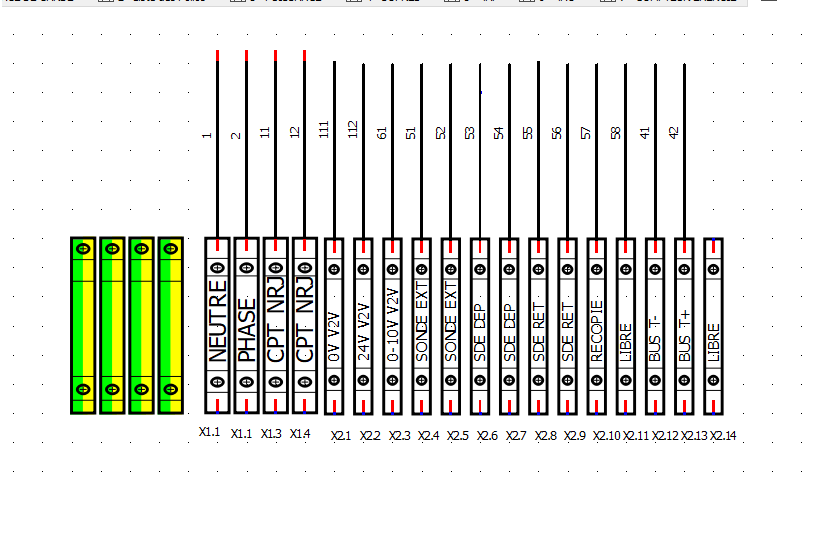

Hi Unalcade,
could you add possibilites to a add free terminal on table : between two used terminals or at the end ?
I use this method, but it's not a beautifull solution... When you add 10 or 20 free terminals for exemples.
I think, if we can add line on edition table it should be great.
