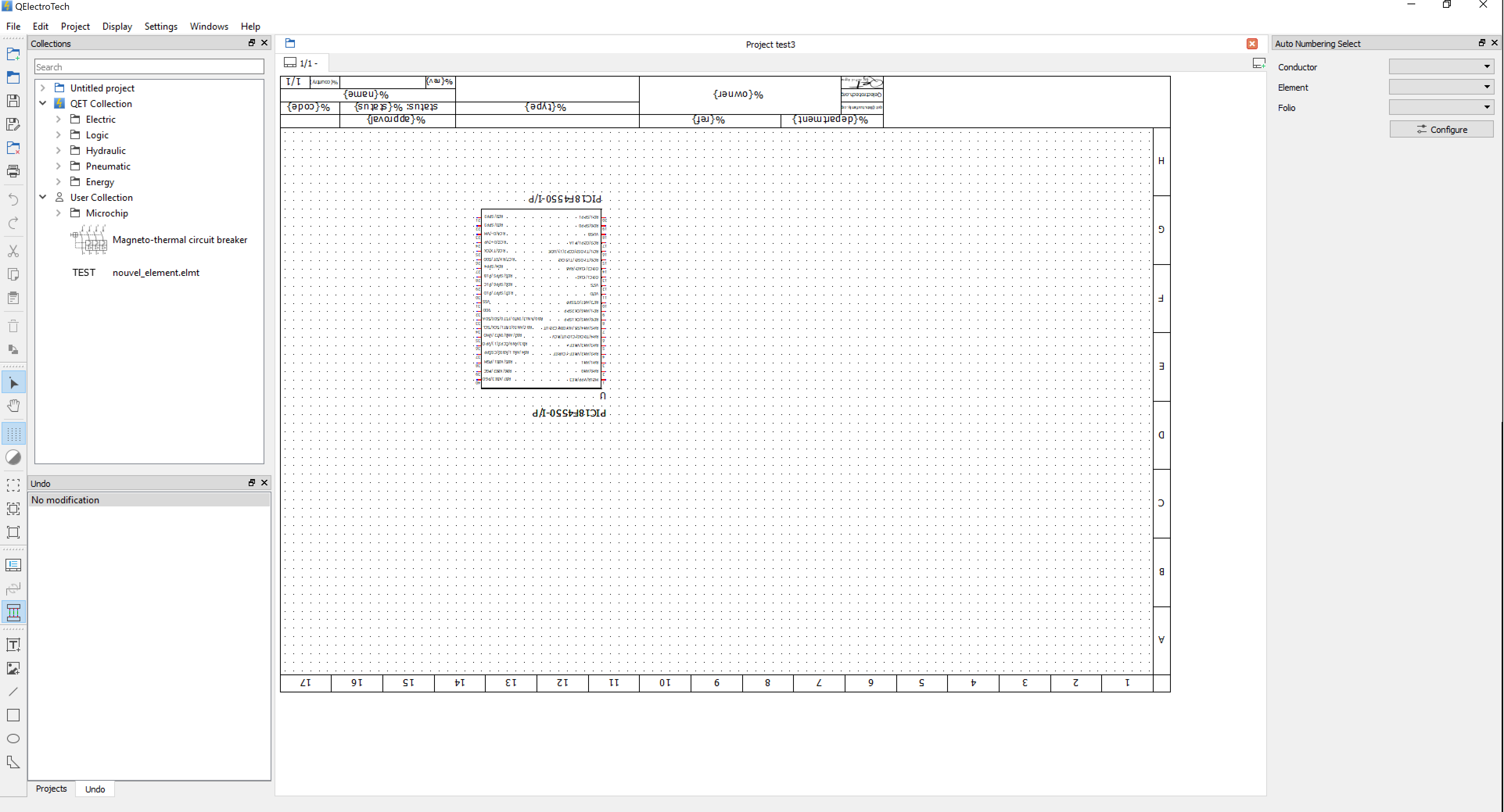

Descriptionwhen i scroll mouse to lower it flips the diagram

Aahh ! I saw the same things one time, thanks to report it.
