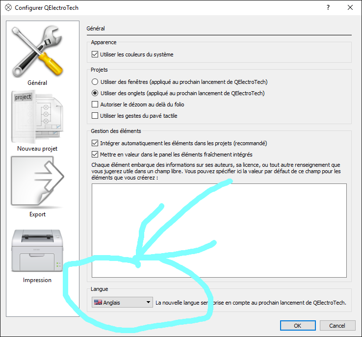

| Description | When I set the language to English and save, then restart the program it is still in French. | ||||
| Steps To Reproduce | see above | ||||
| Additional Information | version 0.5 | ||||
| Attached Files | |||||
I now downloaded the 32bit zip and it works. So the problems are only in the 64bit version. Screenprint is of the 64bit version. |
oops, spoke too soon. I changed the language to Dutch and now everything is in French again. And it will not save the correct language anymore. |
I changed the .bat file to: set command=bin\qelectrotech.exe --common-elements-dir=elements/ --common-tbt-dir=titleblocks/ -- LANG=en_EN --lang-dir=lang/ --config-dir=conf/ %* So I added the --lang=en_EN and now qelectrotech is in English just like I wanted. |

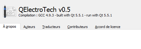

I use windows 10 and I have the problem I use this version: see qe_1.png picture, it is a release version I think. |
Ok, but you could try latest devel version? https://download.qelectrotech.org/qet/builds/nightly/2017-02-16-1/ |
