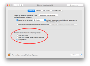

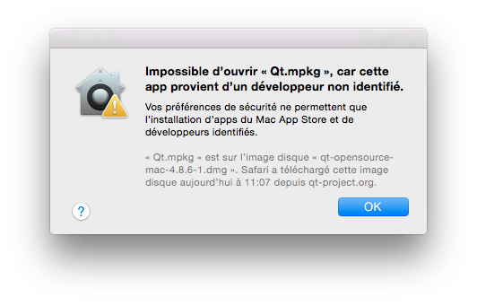

PS : If you have this error message:
Go to / System Preferences / Security & Privacy / General.
And select “Anywhere”
