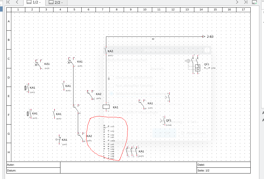

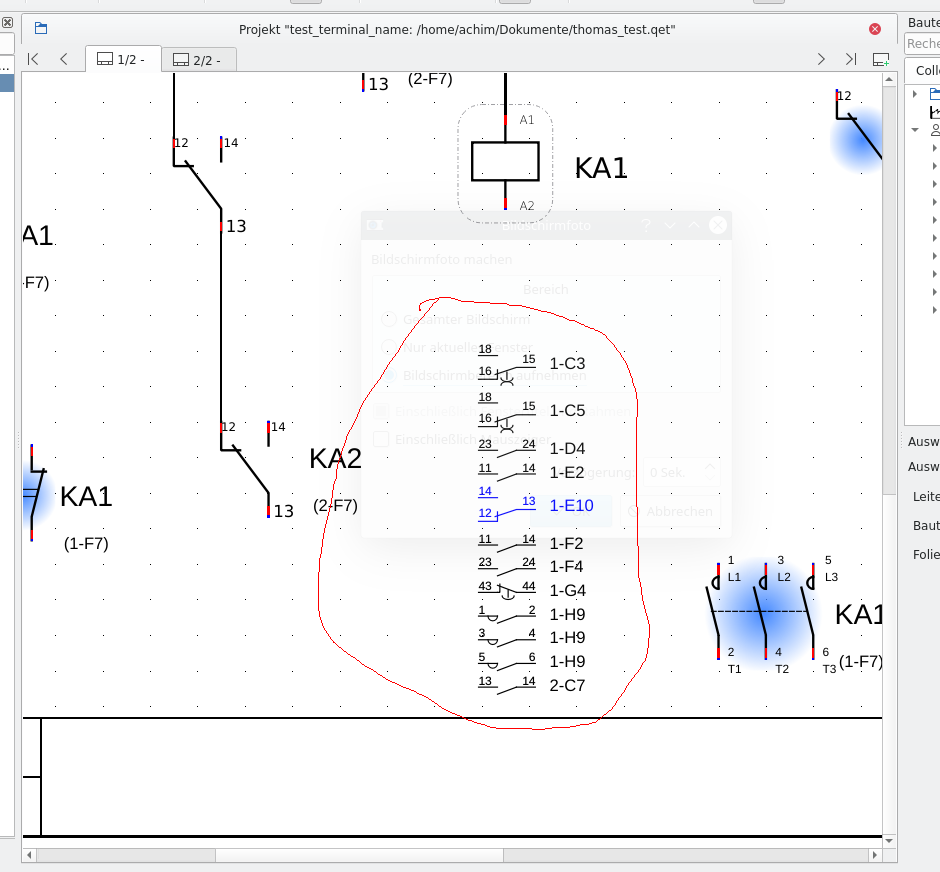

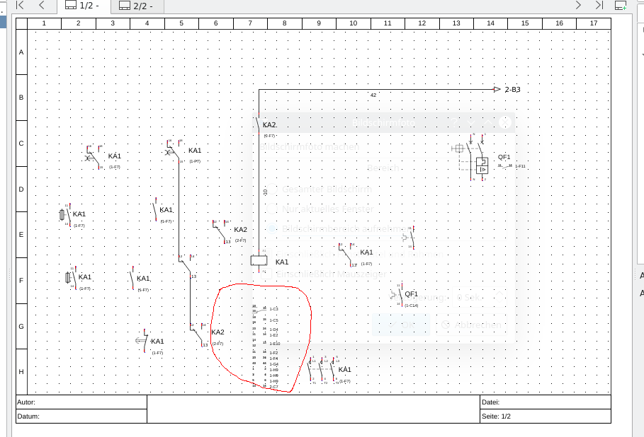

Hello Laurent,
Great work—the labeled contacts in the contact mirror are a real improvement.
I just tested your patch in a simple test scenario, and it seems to work well.
I also just opened an older project, and I noticed that the labeling was incorrect for many of the contacts. However, this isn't due to the code itself, but rather to the way I originally drafted the schematics (I often only changed the visible text) and the symbols (specifically the changeover contacts) in that project haven't been updated to meet the new specifications yet. Would it perhaps make sense to add an option in the program settings to toggle the contact labeling in the contact mirror on or off? That way, users could disable the labeling specifically for older projects

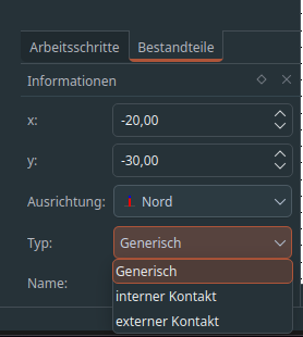

I installed the new update that was offered to me via Discover.
I don't see the new selection of connections in the component editor. Also, for a 3-pole normally open contact, it still only shows 1 and 3, and yes, the program is now crashing more often for me in the component editor.

achim wrote:
Hello Laurent,
Yeah, the feature is really cool overall—it makes the schematics look even more professional.
However, as you suggested, it would be great if we could disable it for older schematics until the feature is 100% reliable.
Hello Thomas, can’t you see the new option in the editor for terminals?

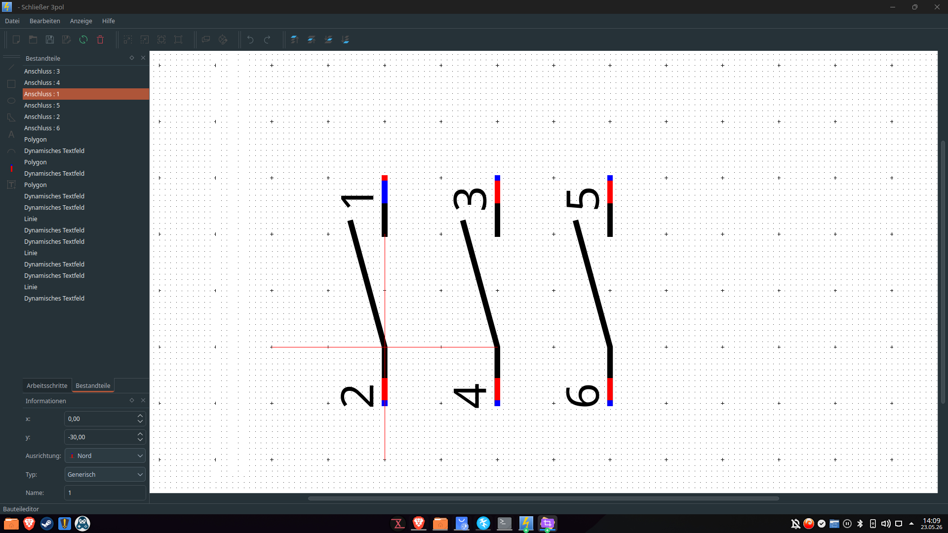

258 (edited by Kellermorph 2026-05-23 13:04:32)
Re: Nouveautés de la version de développement 0.9 and 0.100.0 -0.100.1
As for the crashes in the element editor, I’ve noticed that I can cause the programme to crash by quickly changing the size of a static text input field using the mouse wheel. I can reproduce this even on older versions such as 0.7, 0.8, 0.9... I’ve checked on my Windows 10 virtual machine running the latest MSI installer, but I can’t reproduce this crash.
no, i just can see the old 3 ones
Bildschirmfoto_20260523_130148.png, 20.13 kb, 278 x 310
See log and check the version git hash.
You use my PPA or snap, for snap I don't deploy it to stable channel yet.
Or you use my Debian deb repository?

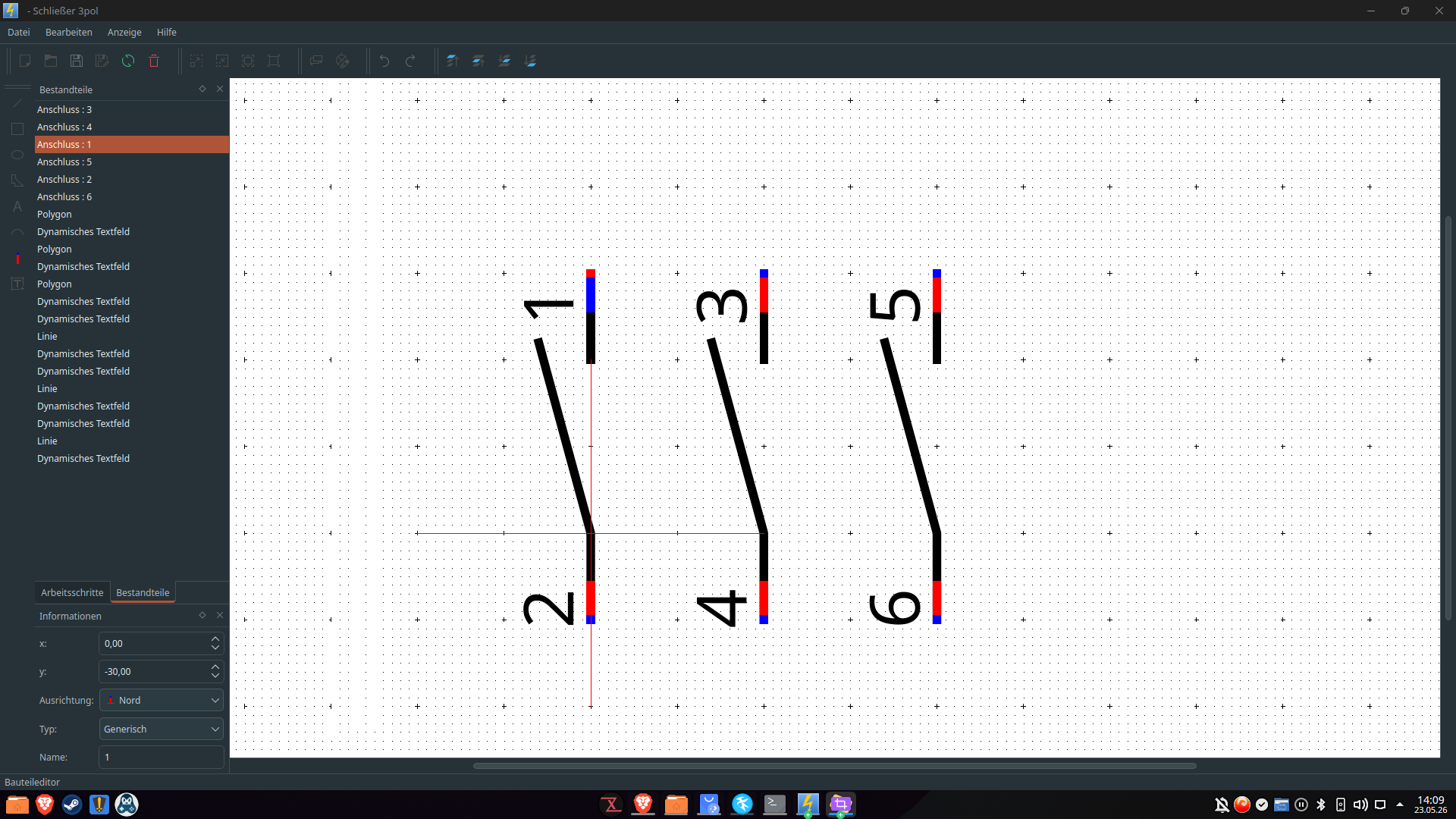

oh yes you are right. i Got a new Version. Now the new contacts are there. But the 3-pole normally open contact are still numbered with 1 & 3 not with 1,2,3,4,5,6
Bildschirmfoto_20260523_133332.png, 6.59 kb, 164 x 154

Bildschirmfoto_20260523_140933.png, 197.27 kb, 1920 x 1080
Is your element a power element?
See my contactor power element.

Hello Laurent,
I tested using the current AppImage as well as within Qt Creator using the latest Git clone, and I encountered frequent program crashes. However, I was unable to reproduce these crashes reliably.
The crashes occurred :
- when clicking the Line Tool button in the diagram editor;
- when dragging a contact element into the diagram;
- when using the mouse wheel (this happened frequently).
Furthermore, I noticed that when zooming, the contact lines in the contact mirror disappear (see photos).
I do not use the ccrossrefitem.patch
