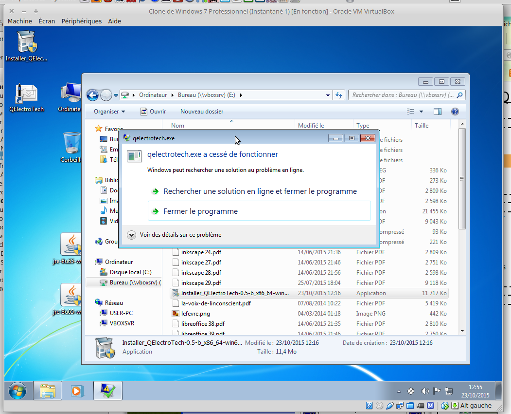

I installed Installer_QElectroTech-0.5-b_x86_64-win64+4234-1.exe on Windows 7 Pro french version.
I works fine but when I quit it, it crash.
Steps To ReproduceStart and then, quit QElectroTech.

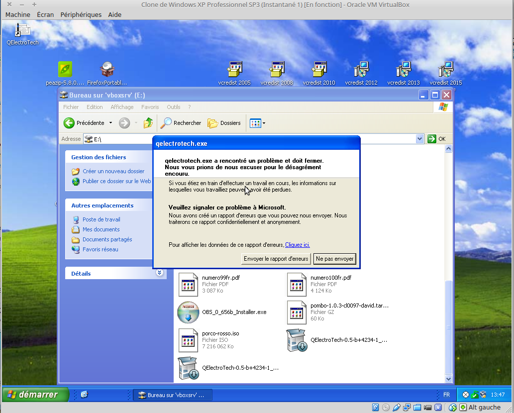

Same crash with Windows XP SP3 french version.
