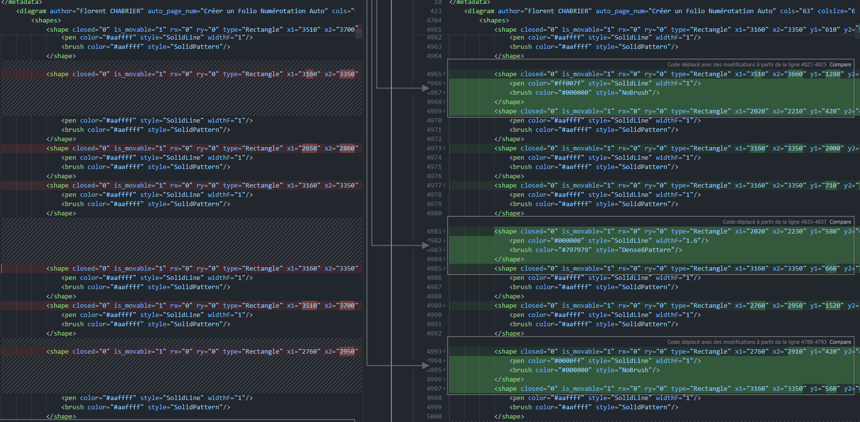

Sadly no, I just checked and the exact same problem still happens with our file. You don't even need to change anything in the diagram, just open/save/close. and do it again. the file will be different. I checked with my attached file in the issue. In 0.200 from 5 hours ago, I opened the file and saved it (no modifications). If I close/open/save, this file doesn't have the problem of modified content. BUT, if I move one element in the file, all the <input> section items have changed position in the list. In vscode diff visualization, it can detect that the items were effectively moved (see attached picture). I updated the git repo to show this problem. |
