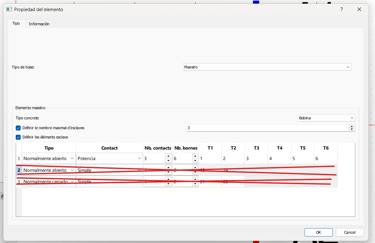

| Summary | 0000339: The interface to set the maximum number of slaves is not working | ||||
| Description | There is a problem when viewing a master’s settings in the element editor. After adding several slave elements on propieties, clicking OK and saving the element, when you reopen the element’s propieties, the list of slave elements only retains the first slave element. QElectroTech V 0.100.1-dev Compilation : GCC 16.2.0 Built with Qt 5.15.19 - x86_64 - Date : Aug 13 2026 : 09:48:17 Git Revision : 2186d2733fd19c2d86172389c9e48e45d54fe332 Run with Qt 5.15.19 using 16 thread(s) CPU : RAM Total : 24 GB RAM Available : 11 GB GPU : GPU RAM : RAM Total : B OS : winnt - x86_64 - Version : Windows 11 Version 2009 - Kernel : 10.0.26200 *** Qt screens *** ( 1 : 1920 x 1080 ) ( 2 : 1920 x 1080 ) | ||||
