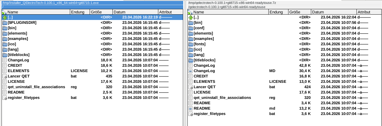

| Description | The windows-versions in installer and Ready-To-Use - Package contain another ELEMENTS.LICENSE than in the source-directory on GitHub! The file at GitHub is significantly more up-to-date and contains more language versions! This also applies to these files: - README - README.md - ChangeLog - CREDIT | ||||
Thanks plc-user. |
Still the win-installer contains very old files in root-directory! These files are different to those at github and in ready-to-use - version. |
see screenshot from double-commander: on the left side installer, on the right side Ready-to-use. both versions downloaded today (23.04.2026) |
