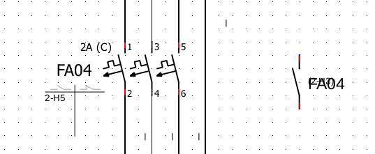

| Description | When I add a circuit breaker and I want to add an auxiliary contact to it, after I assign the contact to the breaker, the label of the auxiliary contact overlaps with the other text. | ||||
| Steps To Reproduce | Add circuit beraker to the schema. Add NC contact. Assign the NC contact to the breaker. | ||||

Please search the QElectroTech-Forum for that topic! Use the keyword "overlap"! You'll find some threads how to solve this. |
It's not a bug ... just change setting: Menu --> Settings --> Configure QElectroTech --> New Project --> Tab "Cross References" --> Set Positioning by Master-/Slave-Type |
