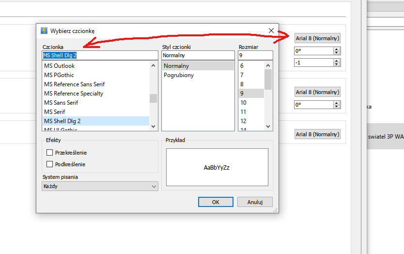

In the program settings, in the text tab, they call up the font window, the default font is always "MS Shell Dlg 2", despite changing it to another one.
pLukas
This will be fixed in 0.100-dev very soon in combination with the availability of included Liberation-Fonts!

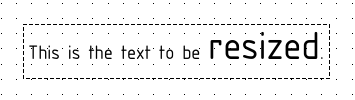

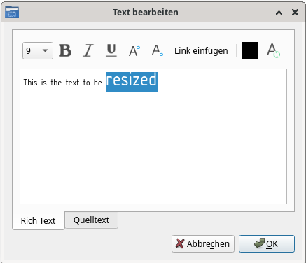

When inserting a text field, even though the font size is changed, the actual size will not change.
pLukas
You mean the text-fields in Diagram-Editor?
Cannot reproduce: See attachments.
The font-size only changes for marked text!
