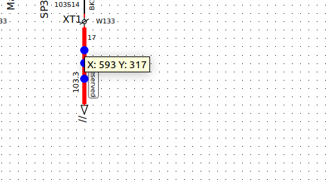

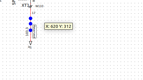

DescriptionHello!
First of all, I would like to thank you for this serious schematic editor that is free to the community, which contains lot of work and free time.
So on my system i found the following bug:
1. Select one already placed wire with left mouse lick (wire will be "thin red" colour)
2. Move away the mouse from this selected wire, than take back the mouse pointer on this already selected wire. The wire will be "thick red"
3. Clicking with right mouse button, the program will crash
I am also a little exercised C++ programmer, I don't want to be fussy, but it seems to me that an exception occurs due to an invalid or null pointer in the event triggered by the right mouse button in this special case.
