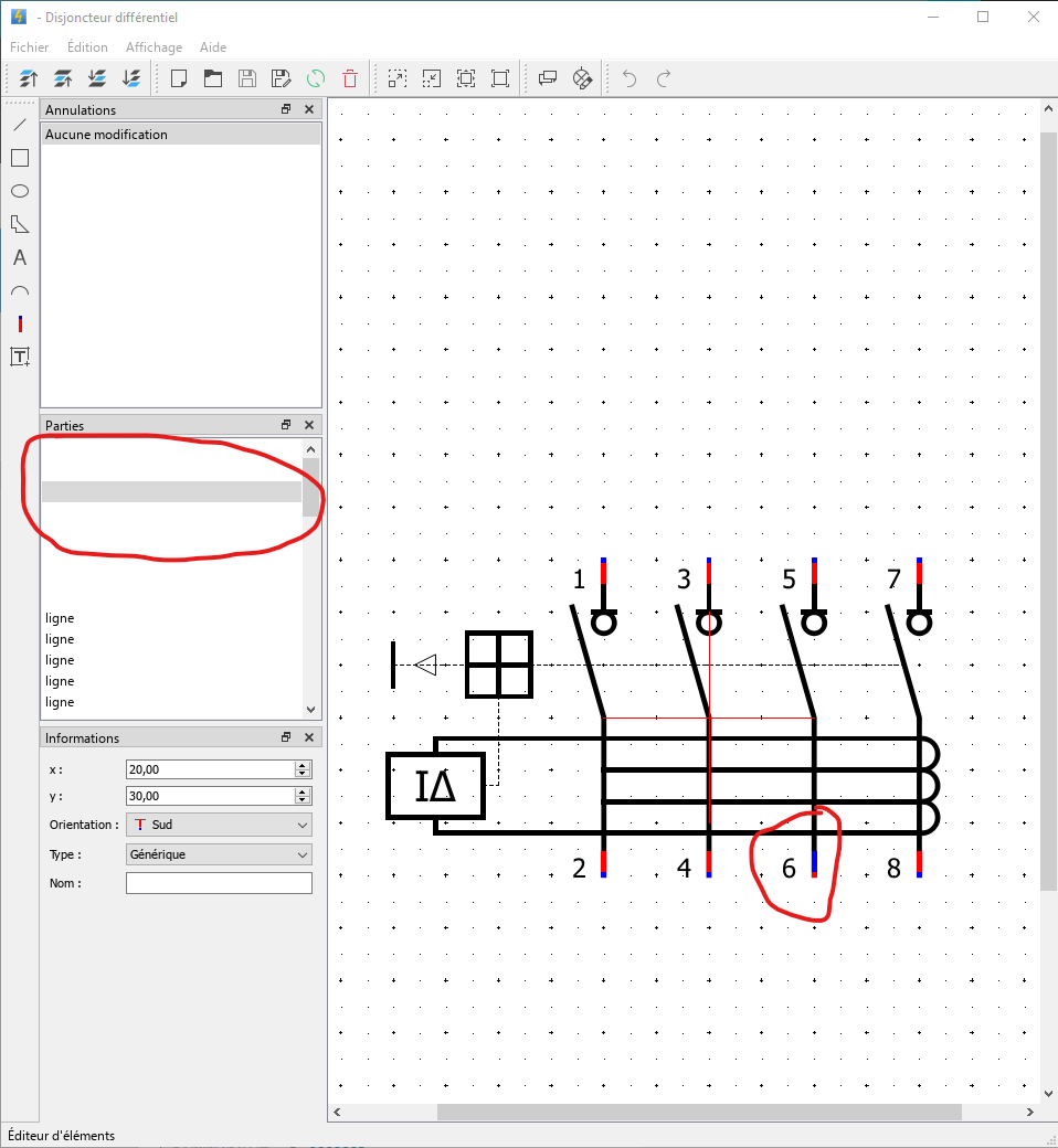

| Summary | 0000284: Bornes non affichés dans la liste "Parties" | ||||
| Description | Dans la fenêtre "Parties", les bornes ne s'affichent pas. | ||||
| Attached Files | |||||
Fixed in QElectroTech 0.100, by commit ff3b497 (February 2024). Terminals now show in the Parties list as "Borne", followed by the terminal's name when it has one. https://github.com/qelectrotech/qelectrotech-source-mirror/commit/ff3b497da2d383b7c86feec05f0c60209680b9a4 If you still see blank rows in 0.100 or later, add a note here and we will reopen this. |
