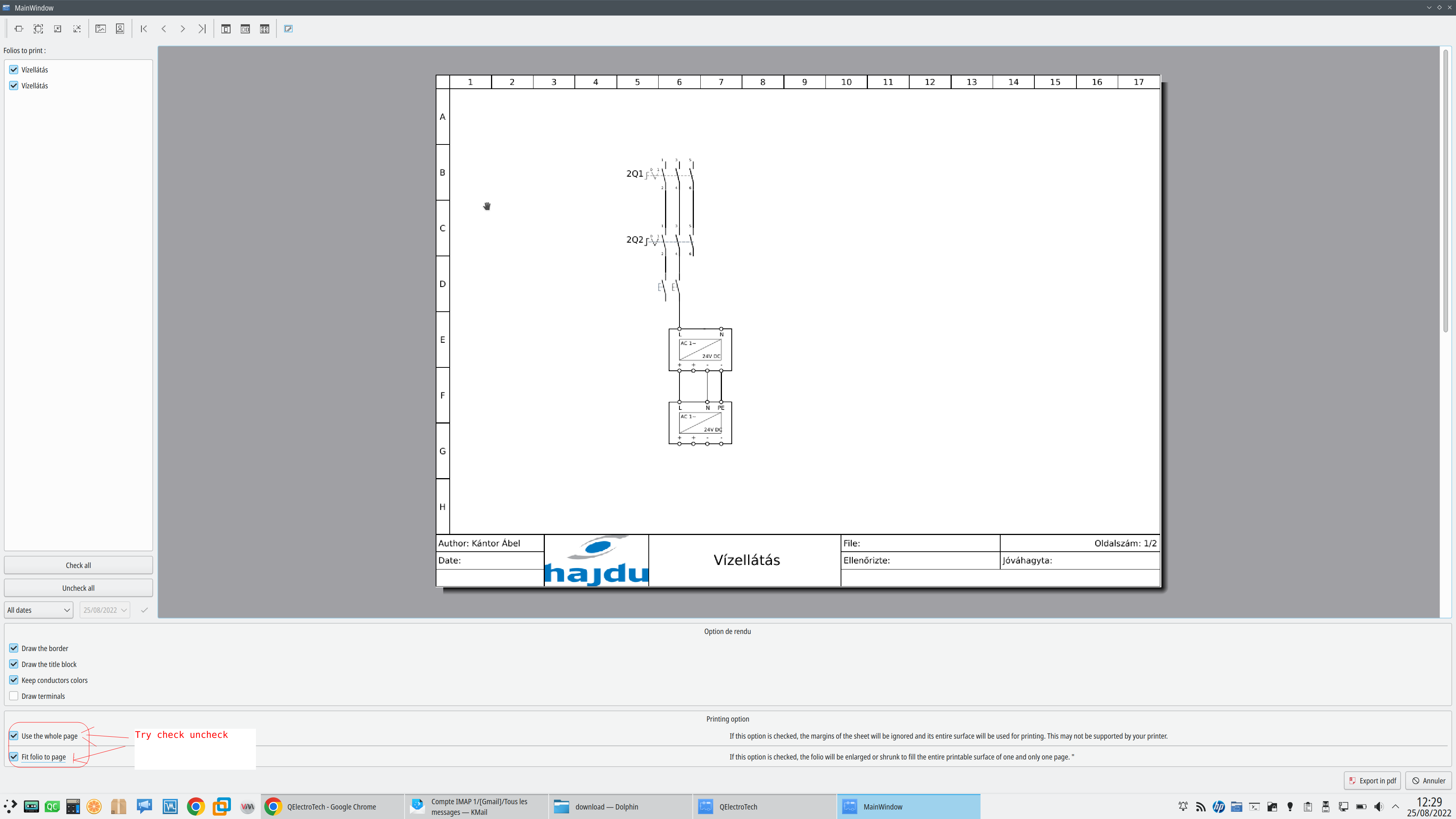

Description | With 0.8 and now 0.9-dev versions the printing is shifted down and to the right. If I use the "Export in pdf" button, it does the job, but from there, my printer doesn't print out the fine lines (like a push buttons head and the dashed line). If I use the print function, but instead of my printer I choose the "Microsoft print to PDF" option, it's shifted again in the .pdf file. Even with an empty folio. Strange thing is, I don't remember having this issue for the first few times printing. I love this software though, much love from Hungary! | ||||

Hello kantorabel, thanks for compliments. Maybe your problem is Windows ... I saw not problem on my Debian Linux setup. |
Didn't expect a response this quick. Sadly my employer doesn't approve on using Linux (I'm no good at using it yet either), so I'm stuck with Windows. I tried checking and unchecking those two boxes, but no difference. Though if I uncheck the "Use the whole page" box, it doesn't shift the page, but that's not ideal, for reading, and leaves me many unused space. I will try to reinstall the whole thing, and see how that goes. If anything comes to your mind I'd like to hear it. Thanks for the quick response! |
Maybe try other printer or try change QET print settings?![]() |
I will make some test with my professional win10 laptop, and come back to you. |
