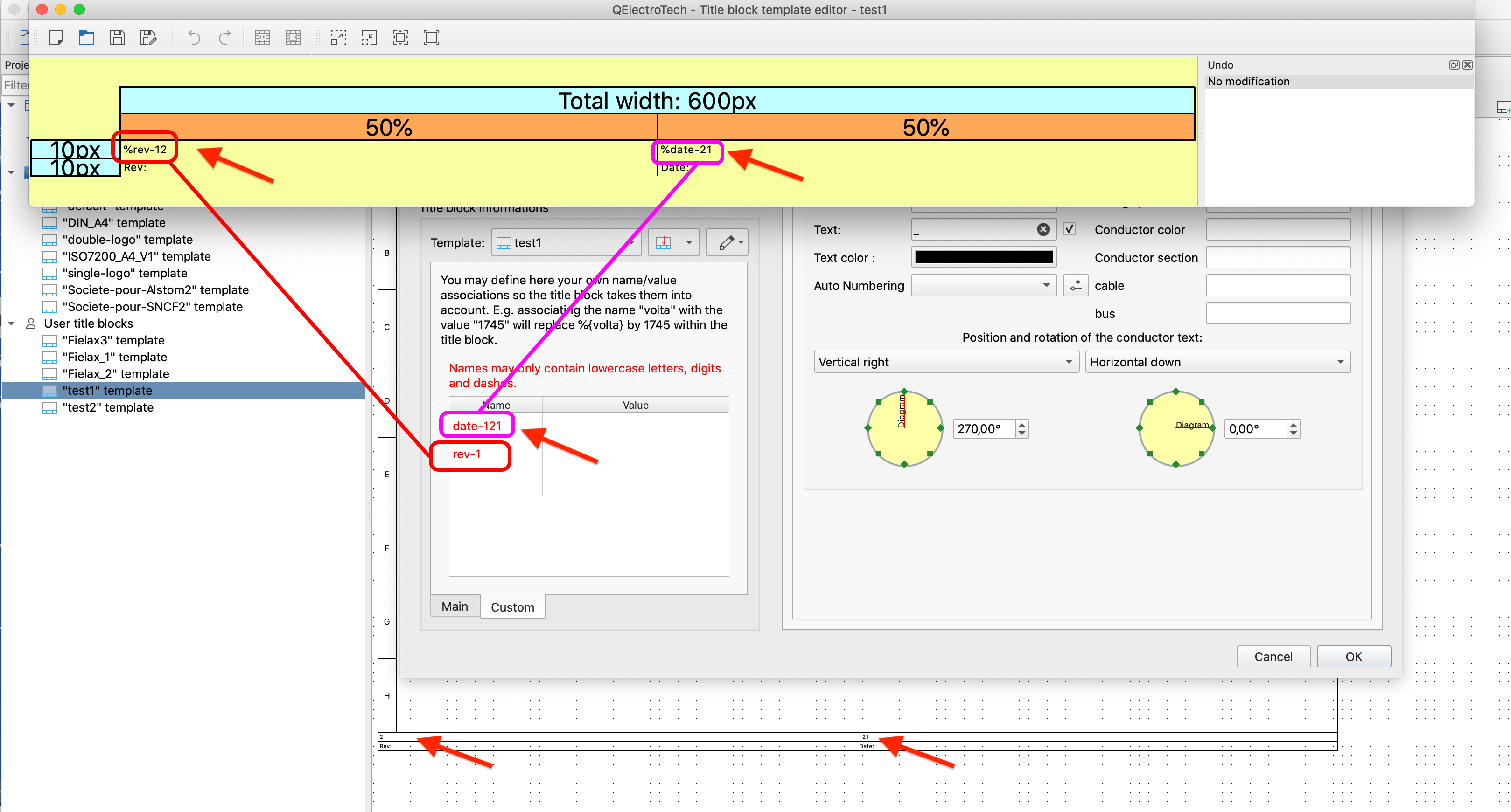

Summary0000232: Custom Title Block Variables are not interpreted correctly
DescriptionCustom title block variables behave as expected in a custom one row title block (see test2.titleblock)
Once i add a second row, the variables are not identified and interpreted correctly (test1.titleblock). See screenshot.

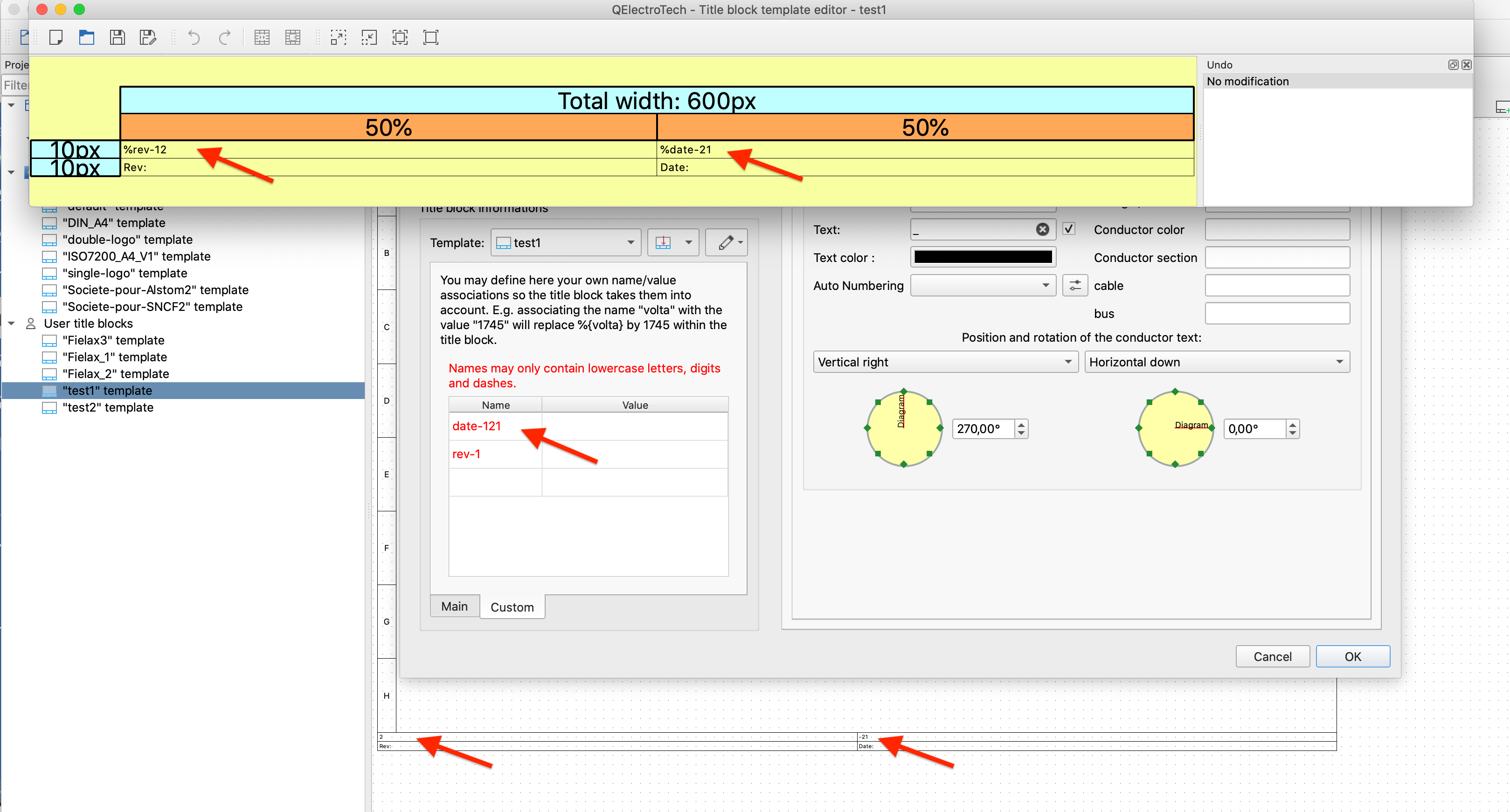

In your screenshot you use different name for variables

reporter   ~0000511
Thanks for the information. I did not realize, that the custom variables can and have to be edited to match the names of the templpate once i import an title block in my project. The variables from the title block templates get parsed on import, but not correctly.
This happens as well, when i import one of the official templates like "Societe-por-Alstrom2"
