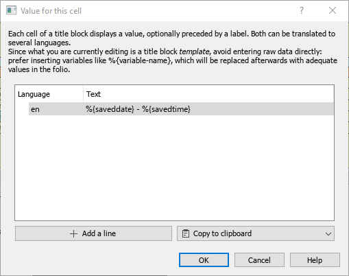

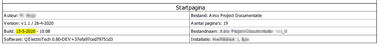

| Description | I have noticed somewhere in the last 100 commits something happened to the %{saveddate} variable. In the past there was a date, see screenshots below. Now there is just number 1 instead of a date. Not the biggest issue in the world but we use that variable to track the document release date. | ||||
| Steps To Reproduce | Use the %{saveddate} variable in the embedded title blocks. | ||||

Fixed by commit: https://github.com/qelectrotech/qelectrotech-source-mirror/commit/9c267d673d8e022d23825b9a3ec5da20f7162457 Thanks, scorpio810. The ticket can be closed! |
