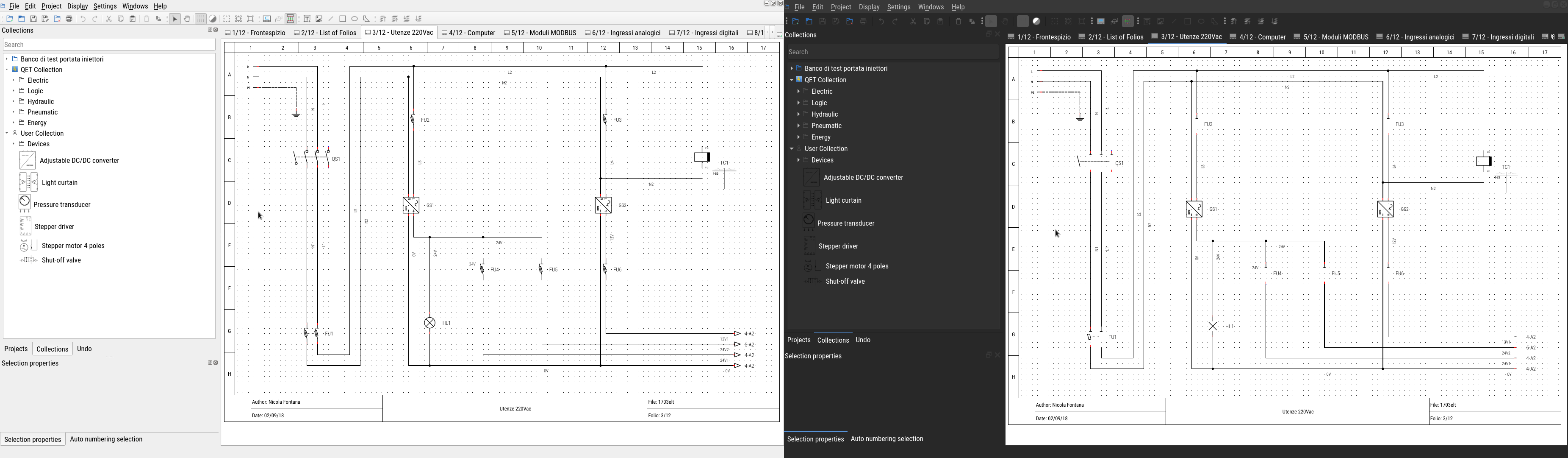

| Description | When a dark Qt theme is selected, symbols are rendered partly in black and partly in white. As a consecuence, part of the symbols disappears on white background and the diagram seems to be "incomplete". | ||||
| Steps To Reproduce | For quickly switching theme I use the following commands: ``` $ QT_QPA_PLATFORMTHEME=gtk2 qelectrotech # Dark because I've a dark GTK+ theme enabled $ QT_QPA_PLATFORMTHEME=fusion qelectrotech # Bright ``` | ||||
| Additional Information | In the attached image, on the left you can see a page opened with a bright theme (fusion) while on the right the same page is opened with a dark theme (gtk2, with a dark GTK+ theme selected). I tried some different theme combinations by using `qt5ct` and the problem seems to affect all dark themes. | ||||
| Attached Files | |||||
As a workaround, you can put the following CSS fragment into `$HOME/.qet/style.css` to force drawing everything in black: |
Known bug, related to Qt. We need to report this bug upstream. |
